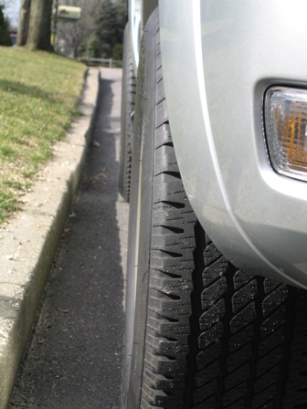

I put about 8800 miles on my SE with the 17" stock wheels and Dunlop tires. A week ago I had the same 18" wheels that come on the '06 Limited put on with 265/60R18 BFG Radial Long Trail Tires ($89 each). See my thread here: http://www.toyota-4runner.org/showthread.php?s=&threadid=15940
Tire rack lists these tires as "Highway All-Season" but they have a much more aggressive tread than the Dunlops which are listed in the same category. After a week of driving on various surfaces at various speeds I can say that the 18's with the smaller sidewall make the truck handle noticibly better. Turn in is much quicker and the truck feels more nimble around town. On the highway, the long high speed sweepers feel more stable. The ride is definitely firmer but not harsh at all, I can just feel a few more road imperfections than with the Dunlops. I'm not sure if that's the sidewall talking or the difference in tread, as I'm pretty sure the Dunlops are a much softer tread.
As for wheeling, there is still a decent amount of sidewall to use, realistically, you are only losing half an inch (radially) of sidewall in the difference between 60 and 65 series tires at this width. Companies should start making all-terrain tires for 18" soon as the tire industry catches up with the bigger wheels being offered on SUV's and trucks.
All in all, I'm happy with the change, any of the other 18" tires would be better than the Dunlops IMO.
