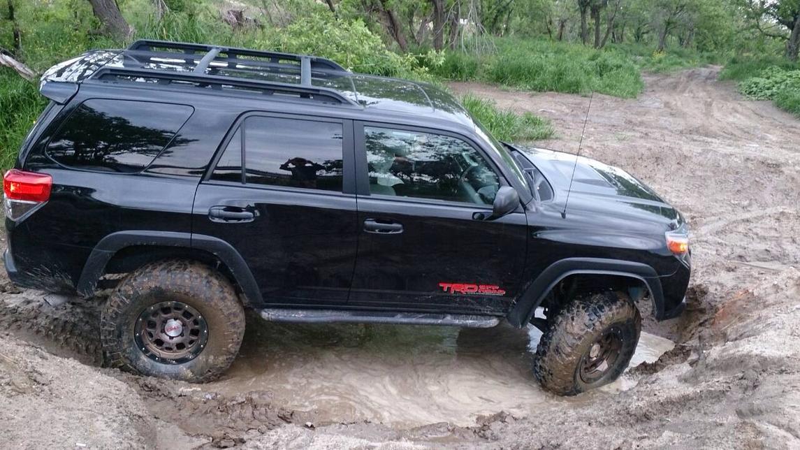

I used 16" wheel before. (TRD wheels 16 x 7.5J +10)
I have put a wheel spacers 1.7" Hub Centric in front, and I shaved front calipers.
But there was little space between front calipers and wheels.
