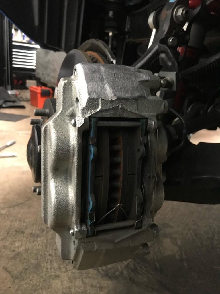

I can tell you first hand the front won’t fit. I had a set of SCS Ray10 wheels that I bought for a 3rd gen. That I wanted to install on to my 5th gen.
I got a set of tires mounted and found out the hard way.
But where there is a will, there’s a way...
I took my trusty grinder with a flap disk and went to town on the front calipers. After working my magic and removing a good amount of material both front wheels fit!
Then I bled the brakes... needless to say, I noticed the pedal wasn’t getting any stiffer.
Then I noticed the river of brake fluid on the garage floor.
I ended up installing a new set of WL calipers and rotors from a 08 4Runner and got everything to fit.

Any pics of the grind fail?
Oh wow. Always wondered if you could grind the calipers to fit the 16s, Do you think you could have gone a little less and still fit the 16s?

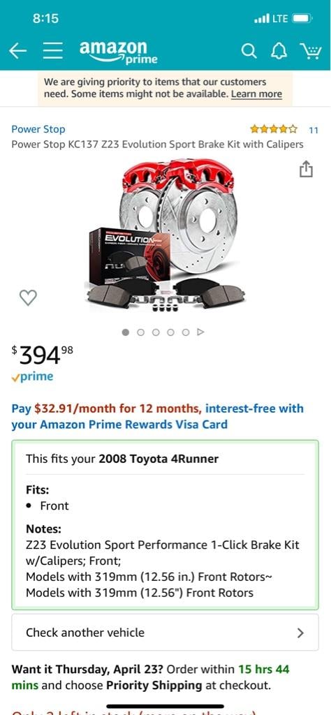

Nope. That was the bare minimum. If you really want 16” wheels, order the power stop kit for a 2008 4Runner with 16s.

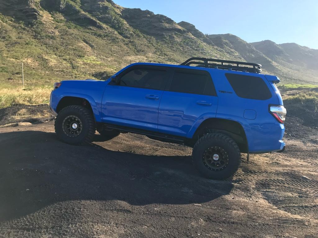

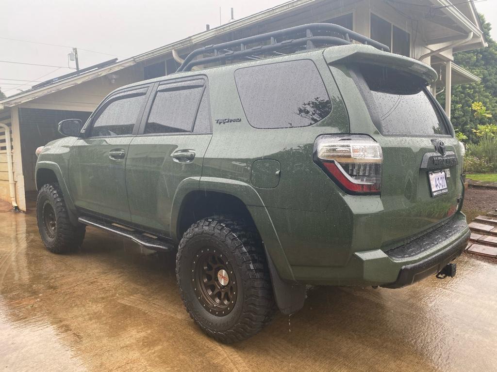

Here is a picture of my wife’s TRDP with 16’s.
