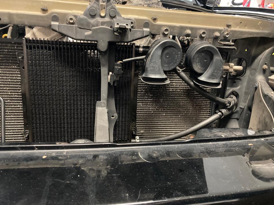

Hey, I hope Im not going to cause anybody discomfort, but I am just now replacing the ATF in my new to me 07 T4R sport with 224,000 miles on the clock (I know, mixed measurements). I first start by draining the pan, and only 3.5qts came out. If you were billed for 5-6 qts, you got overcharged. I would expect nothing less from the stealership.
I plan to tow with this truck, so I did a full atf exchange using Amsoil 10qt jug. Its not cheap ($150) but more resistant to heat. I also added a tranny cooler since the radiator is being replaced now as well.
