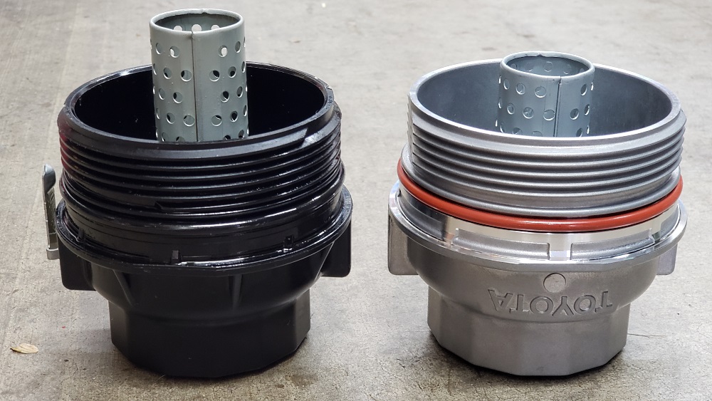

I had a revelation last night at about 3 AM, literally shot out of bed as I thought of it. I think I know how the engine died
About 2000 miles ago I changed my oil, and as part of it I finally did the plastic -> metal filter housing upgrade. I'd bought the metal filter housing like 3 years ago and kept forgetting to put it on. That big delay also meant that I'd forgotten the very important and critical step that you have to do when you make the swap - ensuring that the longer center tube gets transferred over from the old housing:
If the top end of the filter collapsed or shredded itself, well, that could absolutely block up some oil ports somewhere in the engine and cause things to overheat locally without showing any signs of a problem before a catastrophic failure. Obviously, I won't know for sure until I can get to the truck and look at the filter, but this is the closest thing I have to a smoking gun right now.
I could understand that causing a bottom end knock or frying the cams but I don't see how it would cause fluid in a cylinder/cylinders and low compression.
There's videos of engines being run deliberately with no oil at all and they don't lose compression due to it, they normal fail when the block gets a ventilation hole!
I think you might have got lucky with the oil filter and it could just be a headgasket, or an overfuelling injector maybe? (Would also explain carbon build up) Finding the fluid type would be handy, that garage had what we call a "More than my job's worth" attitude IMO.
What were you thinking when you went with metal filter housing? Like metal is better than the original OEM plastic design?
I have the original OEM plastic housing on our 2014 and it’s rolling past 430K miles this weekend.
It can be easy to get sucked into the "it's an upgrade" game. Especially if one hasn't experienced the reality of past said "upgrades."
It is an upgrade if done correctly. With the metal one you just tighten until it is snug and go. There are many reports of the plastic housing cracking and leaking, especially when letting a shop do your oil changes.
I have been a mechanic for over 45 years and the T4R oil filter location (under skid plate on later models) and plastic housing is one of the worst I have seen. Several reports of Toyota shops not changing the filter on the "free" oil changes due to the skid plate drop, as well as all of the stripped out skid plate bolts.
Your 4Runner is a great example of what these vehicles are capable of when maintained. Congrats to you for that mileage accomplishment. I hope to get the same from mine.
The metal filter will not degrade and become brittle like plastic, nor will it crack from being overtightened (although I am sure some mechanics could even screw that up).
I respect all opinions, and this is just my opinion from having many Lexus/Toyota products in the family. I have upgraded all of the ones with a plastic housing to a metal one. You just have to get the right one and swap the tube if necessary.
On another note, I would be surprised if that is what caused this issue due to the strength of the inner wall of the filter itself, assuming that it was a Toyota filter.
OP I feel for you brother. Please keep us updated.
Snug is all you need to do w/ the plastic version as well. Don't over torque it, use an appropriate cap wrench, and it's a forever part. Plus the thread dimensions/surface finish differences compared to the plastic version are a non issue if one doesn't swap. Not to mention the inner filter support tube swap which some have fumbled. It's an answer to a question which hasn't been asked.
