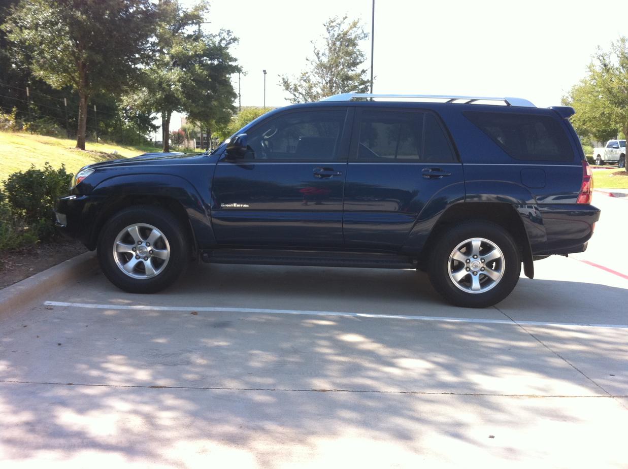

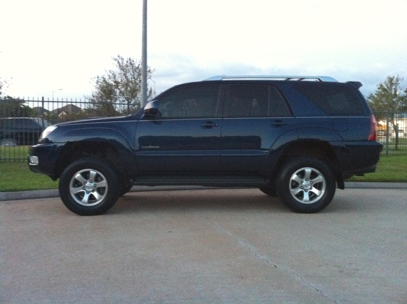

I have lifted my 03 4runner sport with FJ springs and Daystar 1 and 1.5 inch spacers. I still have the stock wheels and tires and want to do an upgrade to some all terrain tires. I was thinking about buying the 18 limited wheels but am concerned about rubbing issues. I also read that the sport edition have bigger brakes. Will these wheels fit on the 4runner with no conflict to the braking system/rotors? Would the tires rub if I upgrade to 18inch wheels? Should I just stay with the 17's and upgrade to 265/70/R17 tires? Any help and opinions would be much appreciated. Thanks in advance.... I've attached a couple of pics before and after the lift...

as an aside, your 4r almost looks too level. you want a little bit of rake else you're going to look like many of the neglected 3rd gen 4rs on the road today.
