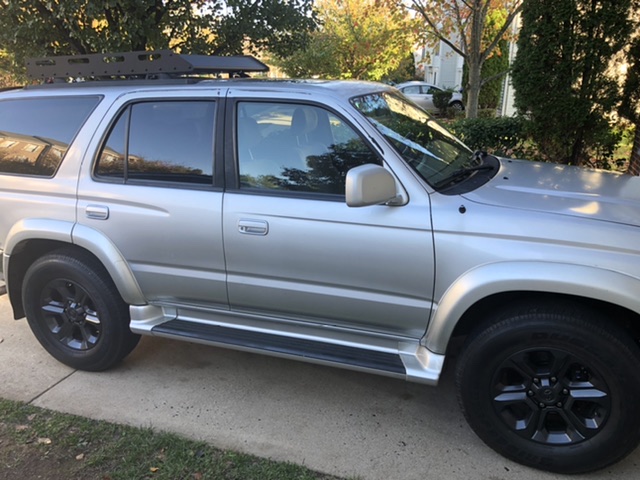

I installed them today and roof rack
Tires are 265/70/17
FYI. No lift no spacer . 2001
