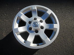

I'm wanting to with a black rim and I'm wondering if a 17" rim will fit on my Limited? I'm sure it will as I think only the Sports have the larger brakes(?).
Second part, I've always liked the Nissan Titan off-road 17" rim and I can get a set pretty cheap. I know the bolt pattern is the same, but I'm on not sure about the offset. Rim description is below:
17” X 7.5”, six lugs X 139.7 mm, or 6 lugs X 5.5", center bore= 3” offset =30 (ET =30)
Also, I read another member on here said he's running a Titan rim but had to bore out the hub as it was too small.
I plan on getting these powdercoated black...
Anyway, any advice on the brakes and offset would be appreciated.

17" wheels will fit with the larger rotors, 16" wheels will not.
I would be too concerned about offset... center bore would be my concern. The FJ cruiser trail edition wheels I have in my basement awaiting install (which are a direct bolt on fitment to the 4runner) have a bore of 4.5"... just measured them.
good luck and post pics if it works out....
Thanks Nate. I think I'll pass. The hub difference is too much. As I said, I could get these cheap but don't want to spend too much money to get them on the truck.
Thanks again!
