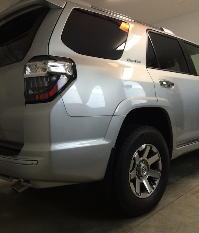

I put 17" trail edition rims with stock size 265/70-R17 tires on my 2013 limited just this past week. I think the new wheels look MUCH better, and the tire selection is better, as well.
Np
No problem, glad it helped! FWIW, those are stock size tires for a Trail, but E-rated Toyo AT2's. Probably overkill for what I do with my 4r.

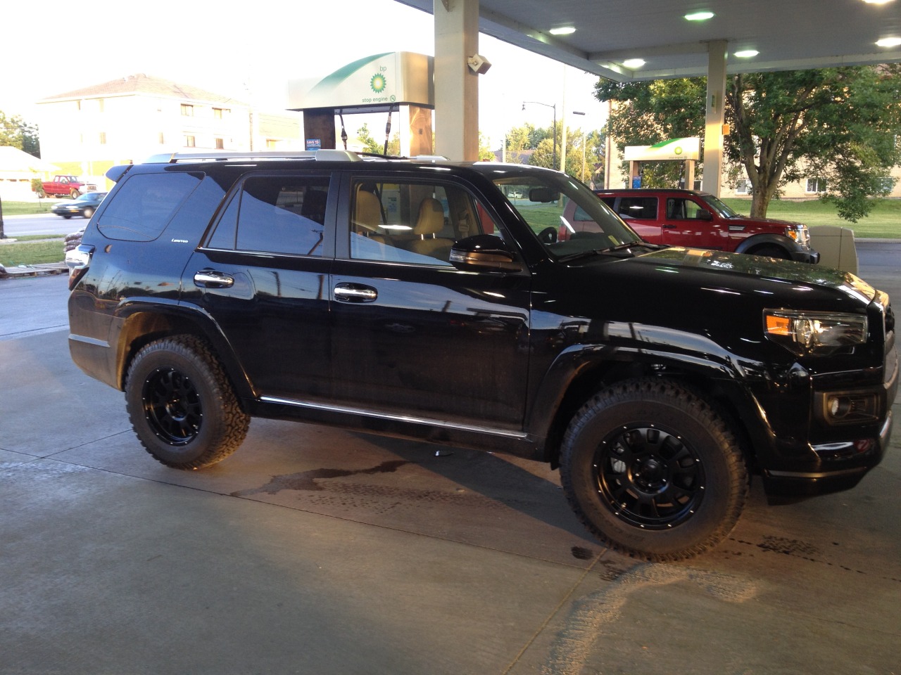

I just wanted to follow up on my own post.
First, thank you for all replies that help me make a decision.
I got a set of 5 17" Level 8 Guardian wheels: Level 8 Guardian custom wheels in the Lafayette Area - Discount Tire
and BFGoodrich All-Terrain T/A KO LT265/70R17E1 121R: BFGoodrich tires for your 2014 TOYOTA 4 RUNNER in the Lafayette Area - Discount Tire

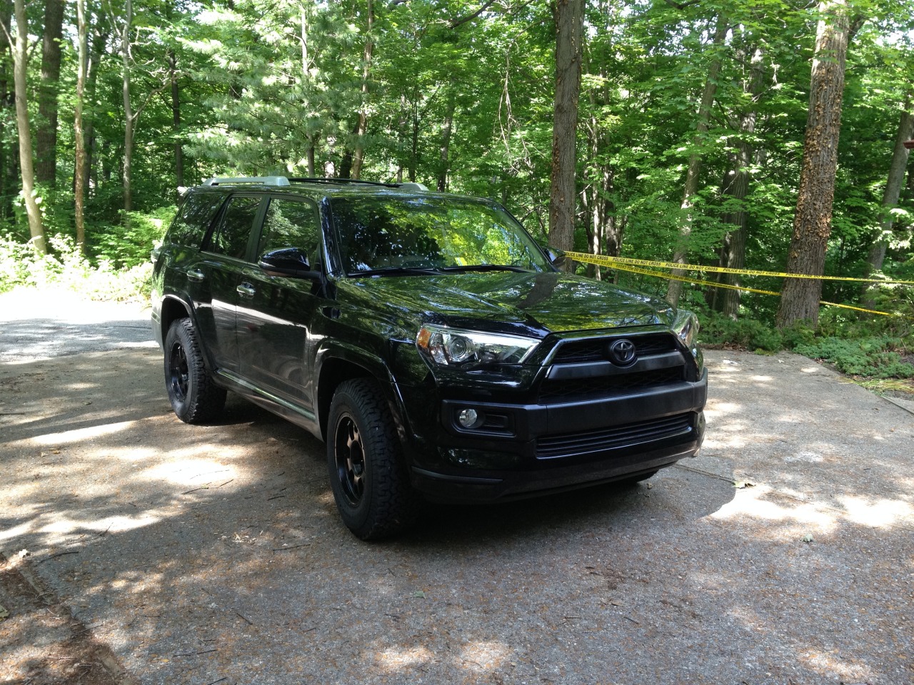

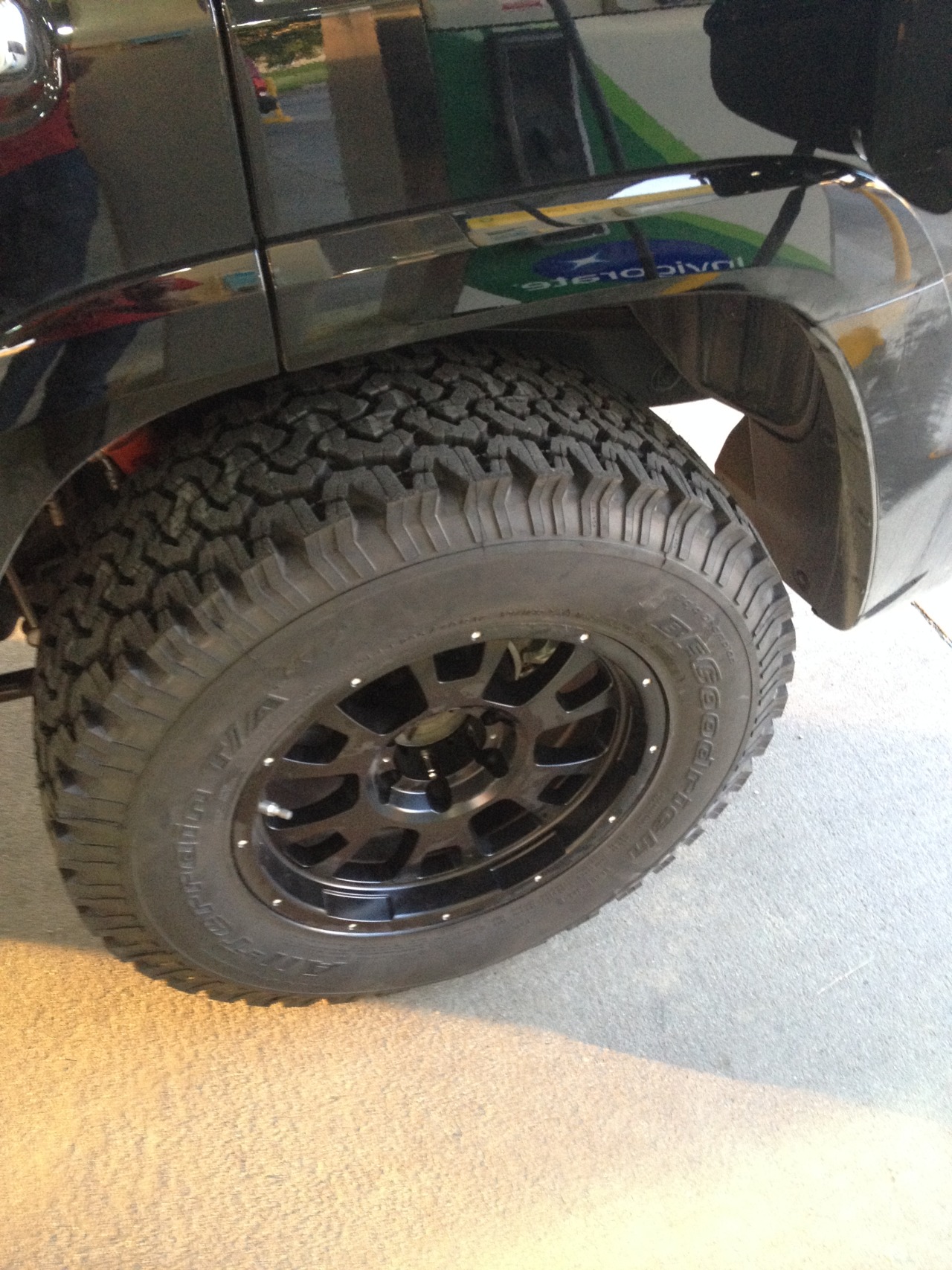

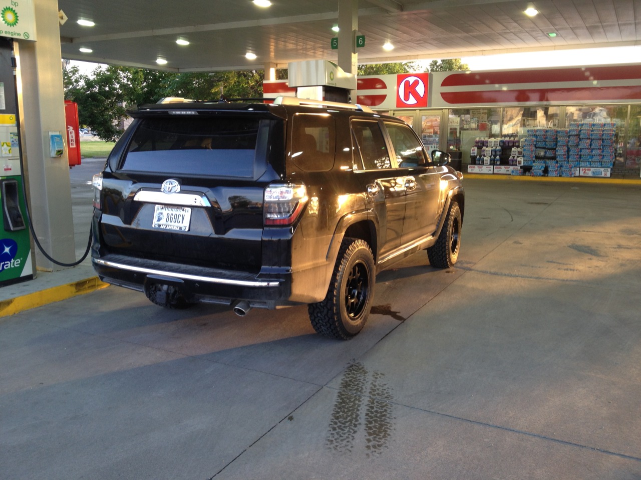

Without any lift the fit is good, wheels noticeably stick out more compared to stock, which looks good to me. No issues with tires rubbing metal. There was some light plastic liner rubbing inside wheel well though. I had to use the heat gun to clear some space for tires in the front, nothing major, just pushed the liner inside a little.
Discount tire refused to sell the wheels/tires without TMPS sensors, so I got them and they need to be reprogrammed. It is a pain, but nothing that can prevent me from driving. On my last trip to CO I had to ignore the warning light for 10 days.
This is how it looks on my truck:

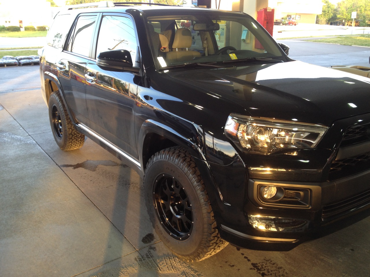

Here are couple more pictures I found on my phone. Hopefully it gives you a better view:
