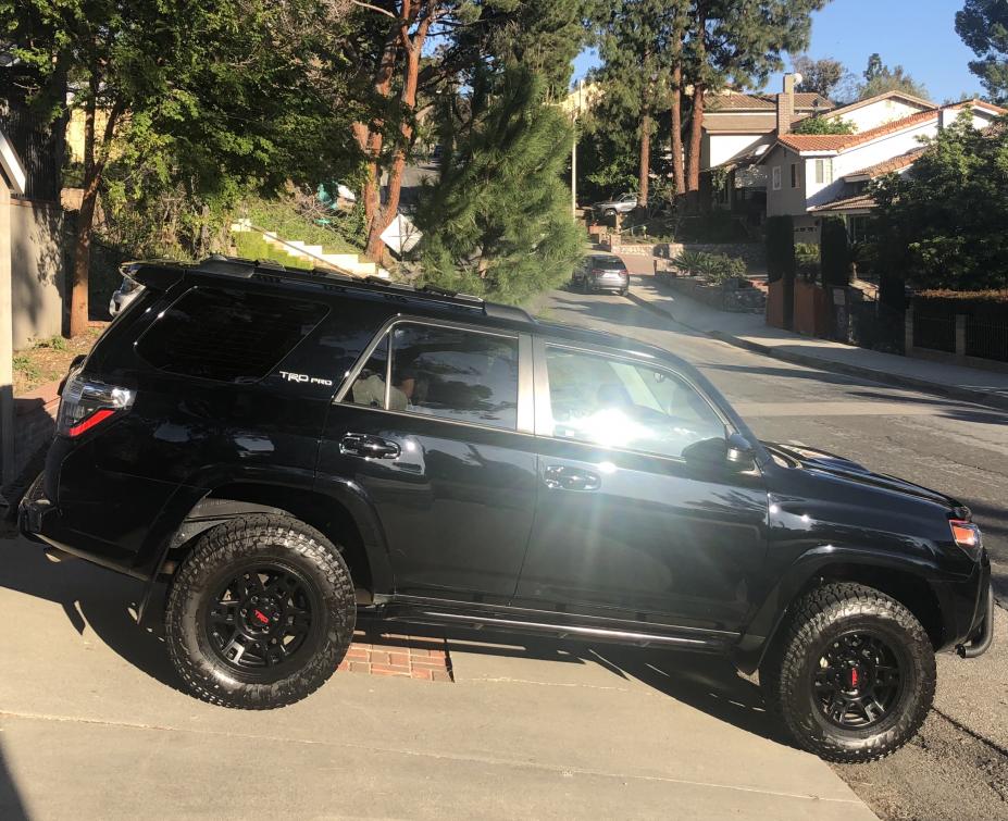

Pic with 285’s on my Pro when I had the 1.5/1” spacer lift.
