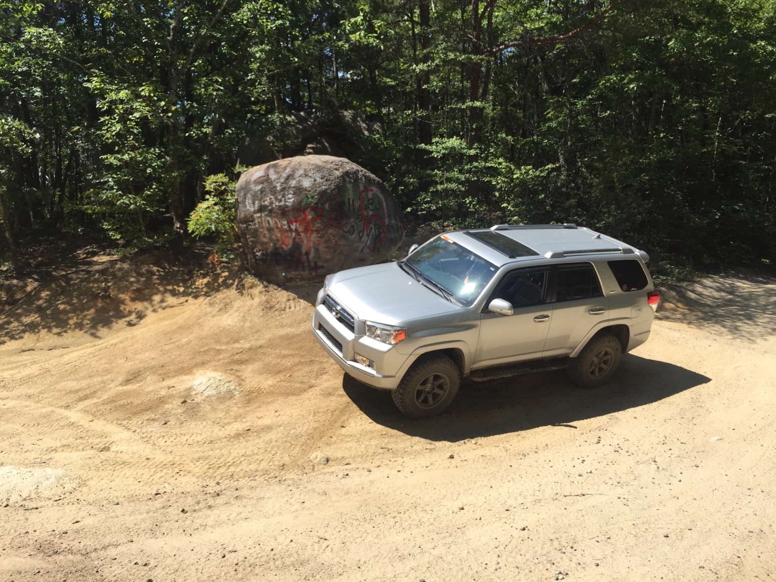

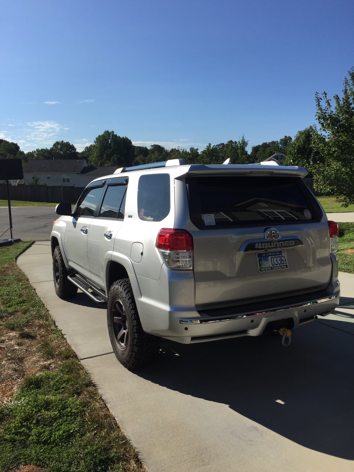

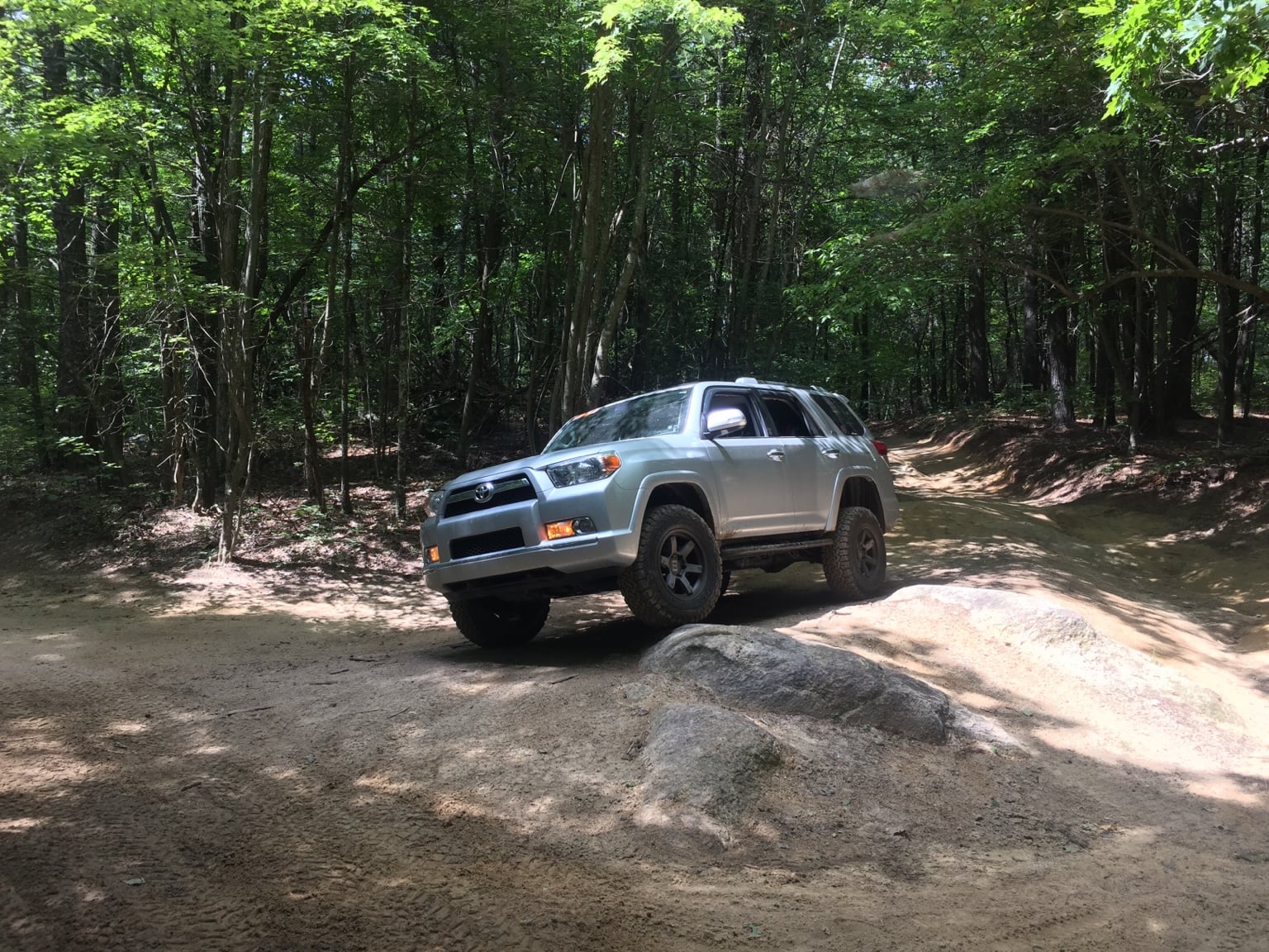

you have a pic of your wheels/tires. I have 17x9 -12 and am trying to decide between 275s or 285s.
Hope this helps.
That is exactly what I was looking for. I was a little concerned as the recommendations I have seen show 9" wheels a little over the max wheel width for 275s. But I'm sure as with most things that is a little conservative. Thank you very much! Your Runner looks great!
