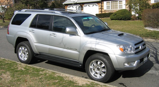

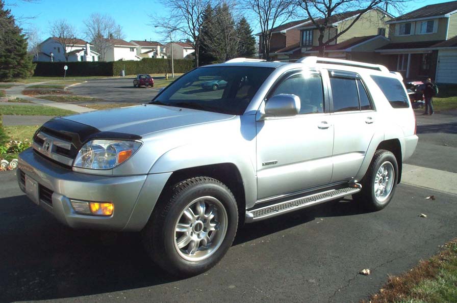

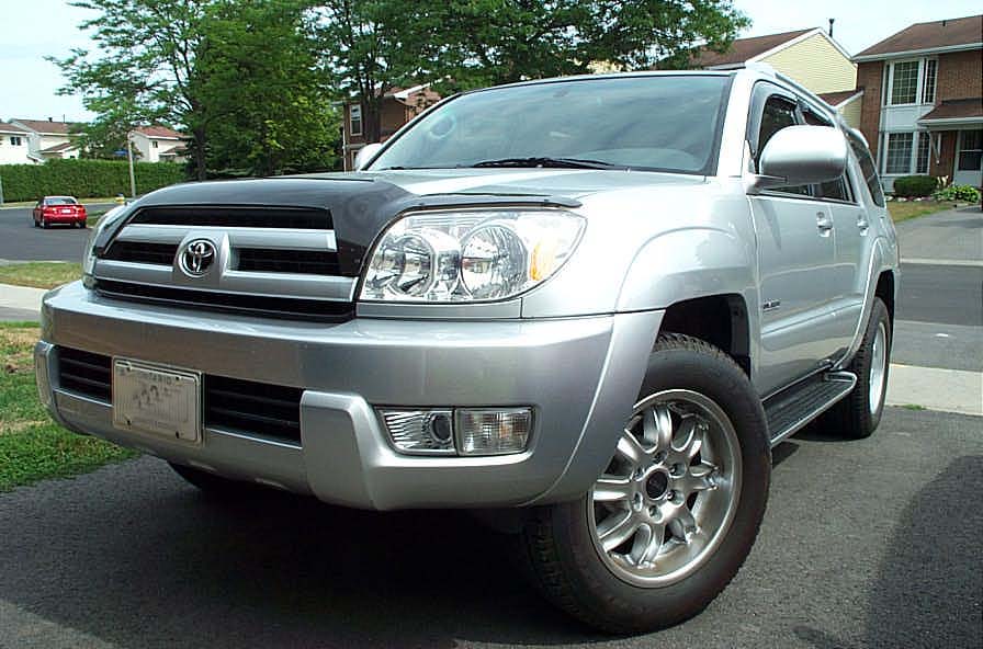

A question was asked of me by AlexJet on another thread about the wheels on my 4R.
These wheels are the TRD 18" Wheel/Tire package offered by TRD last year. They came as a package of 4 wheel/tires for about $1750.00US, If I remember right. They also offered the wheels only at about $400.00US each. I don't think they are still available through TRD as I did a quick check and didn't see them there. These wheels are made by BBS are real good quality and should still be available through wheel dealers who deal with that company. They are the BBS series RW wheels and come in both 18" and 20". I personally find 20" wheels to be a bit excessive for an offroad rig like the 4R, but that's just my opinion.
The only difference between the TRD wheels and the BBS version is the TRD wheels cam with TRD composite centers, otherwise they are exact fit. The OEM lugs fit perfectly as these wheels, like the originals are lug centric. (See Thai's posts elsewhere on the board)

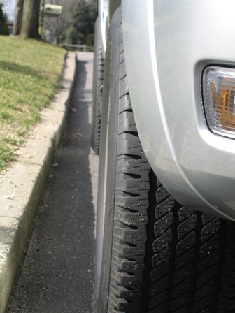

Mine came with Michelin Cross Terrain 275/55 18 tires. A great combination. Although they are a bit wider, they fit in the wheel wells without any problems, no rubbing on the turns etc. and the wheels are the exact correct offset for the 4R with these tires. Tire diameter is very close to the original 17", shy by about 2% meaning your speedo will be off (on the high side) by 2 % (ie if you were traveling at 100 Kph, your speedo will show 102 KPH or there abouts.
I use my original 17" wheels with Bridgestone Blizzak DMZ3, the only tire I could find last year that was 265/65 17. The Blizzaks worked great in the ice and snow, one of the better tires I have used in the winter.
