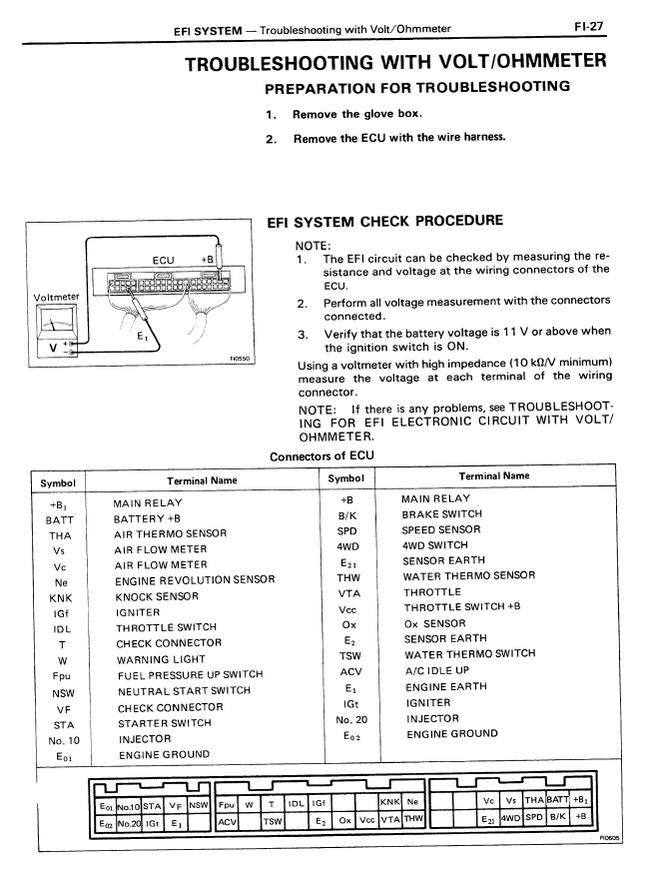

There are EFI checks in the FSM that you can do. They start on page 194.
Link for 85 FSM here. It I think it is the same as a 86, but someone will probably speak up if it is not.

I am guessing there is a pretty good chance I friend my ECU. That is the side of the truck that went under, so it is likely. Can shops test the ECU if I disconnect it from the truck or does it have to driven in?
the ecu needs to be powered to test it and there is no real test to see if the ecu works or not - if you can power it and communicate with it thats about the extent of it
ecu's are pretty tough, there's not much to them - they rely on info from external sensors and then change injector pulse width and timing based on info they receive
i would locate the ecu, remove it, ensure it is dry along with the connectors and find every connector harness that may or may not have gotten wet and blow compressed air in it to dry it out, dielectric grease on the prongs and reconnect everything.
