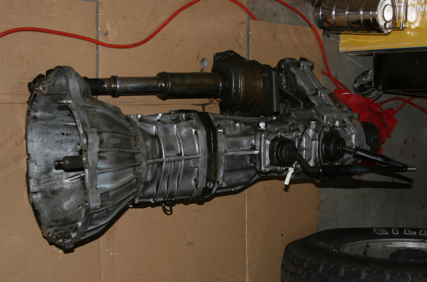

Success!
So after my last post we went to the garage and started getting physical with it! After a few good heaves and a delicate ballet of jacks and jack stands, we were able to get the whole transmission assembly out.

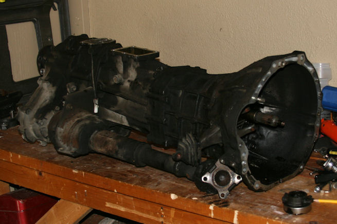

After some degreaser and elbow grease, it is a little cleaner.
There is still much more cleaning to do. I figure since I have it out I will pretty it up a bit. Maybe even through a coat of paint on there before I put it back in.
Just in case you didn't know.. you really need the clutch alignment tool.
If you don't have one, borrow/buy one. It'll save you hours of headaches.
