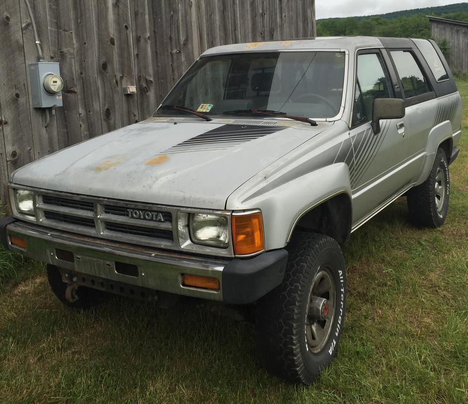

I've been on here multiple times daily trying to solve problems with my first 4Runner and 4x4. Took it to the mechanic, only to receive bad news... it's gonna cost several grand for him to fix the issues:
-New ball joints
-Timing chain
-Exhaust system - front pipe, muffler and tailpipe
-Front brakes
-Doesn't accelerate over 55
-Plus tires
I was so stoked about getting her up and running, it's a classic. Now I have a decision to make. Do I let her go, or keep her?

If you're even somewhat mechanically inclined you can do most of this yourself and save a bundle of cash. Besides the not going over 55 thing (?), everything else is very doable.
NOTE: These may not be the premium parts some folks buy, but I've had good luck with parts in these ranges. You may even be able to find lower prices for some of these parts. Shop around.
Upper/lower ball joints: each side $30-40
Timing chain kit: $100-$200 depending on the kit
Exhaust kit from Rockauto.com: $200 + shipping
Front brakes: Get a couple of caliper rebuild kits $10. Rotors: $50. Pads: $30
Rear Drums & shoes: $120 + spring kits $20-$30
55MPH max: Diagnosis?
Tires: What size/type are you looking for? If you're just doing some mild trails then a set of 31-32 inch all-terrains are fine. You can even try to find some used tires. Warning: be cautious when buying used tires.
If you have the time and the tools you can find detailed instructions for all these online.

I'd agree, its relatively cheap and easy to repair a lot of the stuff yourself with even the most basic set of metric tools! You could slide that exhaust out without much issue, and just bolt the new one in its place, probably take you a half day, maybe longer if the bolts are super rusted. Of course, you could always find a neighbor with a sawzall and make this a 2-hour project!
The balljoints may take a bit more work, but really nothing that hard, you just need to download the manual for your truck (there's links on here for several manuals) and take a full weekend to get it done!
Brake jobs are about the easiest thing a person can do! This really isn't that much harder than pulling the wheels off the front, unbolting the calipers with a big wrench and (IIRC) a 19 or 21MM socket, either taking the old rotors to a parts store to have them turn each one, or buy brand new ones from RockAuto or any other place online, pull the two pads out of the caliper, then reverse the whole process! I literally did my wife's '06 Odyssey van in about an hour's time (replacing rotors instead of turning them), that was for all 4 corners! It would have been faster too if Honduh didn't put a stupid philips screw in there to hold the rotors in place!
Tires? Yeah, you're gonna be around 500-800 bucks depending on what you really want. Personally, I like good tires, so Bridgestone dueler a/t's on my 4 runner was my choice, and that was $740 installed. If you must keep cost down though, look around on Craigslist for used tires, you can sometimes find good tires with 50% or more left on them for a couple hundred bucks, just make sure its the right size and they haven't been plugged.
The only two issues you will have is the timing chain, which is an "advanced" job, and diagnosing/fixing the no speeds above 55mph. I'd say do all the other work first and see if that helps your issue with speed. Could be the exhaust/cat plugged up. The timing chain is still doable, but I'd suggest finding a friend or neighbor that's familiar with this job to help you, it will go much easier, and I bet you can do the whole job for under 2 grand, including new tires!
And just remember, there's a LOT of guys on here who are damned good at diagnosing problems with these engines! I guarantee that your issue will not be the first of its kind, and more than likely, something we've seen many times before!

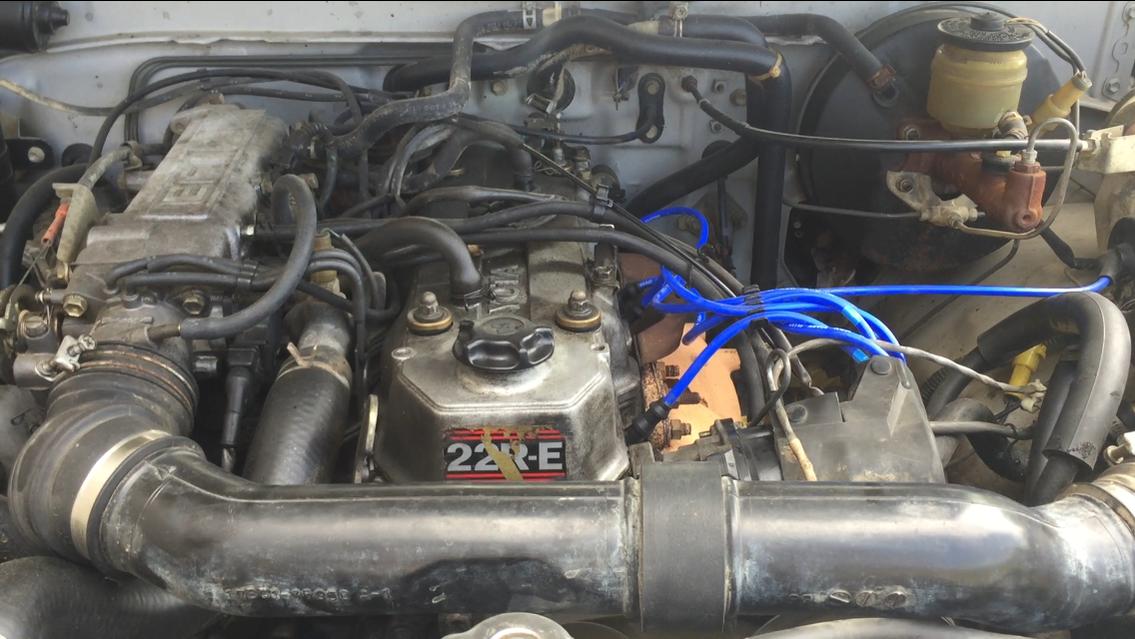

I'm mechanically inclined, unfortunately not financially inclined. I was hoping to get this truck up and running this summer but investing another 2-grand may be slightly out of the question right now and I'm in need of space to work on it.
This is giving me hope though.
I've done spark plugs, spark plug wires, new O2 sensor, air filter, coolant and oil and it definitely ran better. But this engine issue has got me stumped. I've come down to Air Flow Sensor, TPS or fuel injectors. Mechanic seemed to thing it was a timing issue.
