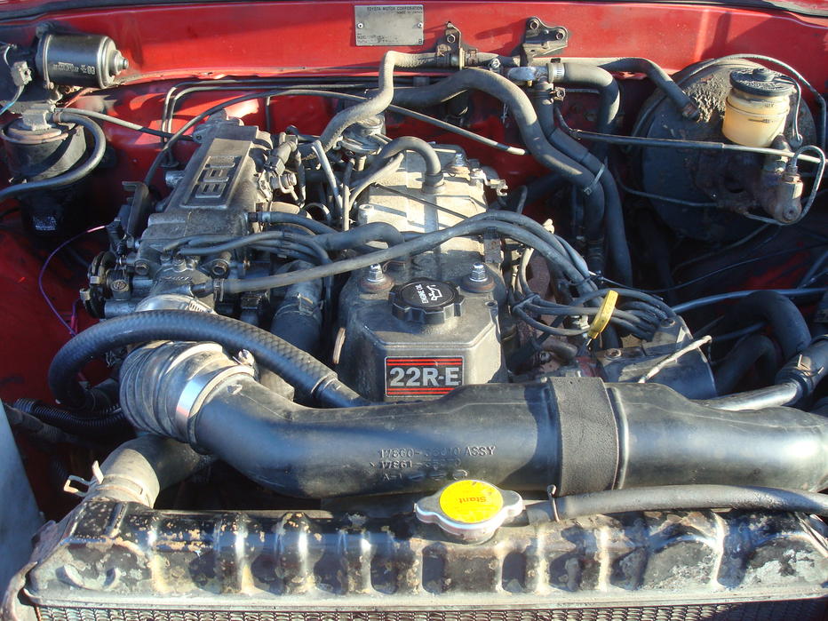

22re from a 1990 in a 1988 4runner. Idles well. Runs well. However, when i accelerate with moderate pressure on the peddle the engine starts to surge. The surge is not so significant that the engine misfires, but you can feel it through the truck. If you accelerate very quickly, the problem doesn't exist. Only on moderate acceleration.

I've put a fuel cleaner through the engine to clean the injectors which may have made the problem worse but I'm not sure if that is coincidence. I have also changed distributor cap, plugs, wires, and rotor.
Any advice from 22RE folks???

A follow up: I think I found the problem. When changing out the sparkplugs, leads, rotor and cap, the timing was somehow impacted. I've advanced the timing by 1mm (ie turning the distributor) - the problem has nearly vanished. In addition, it has given me much more power.
As with most fixes....time will tell.
