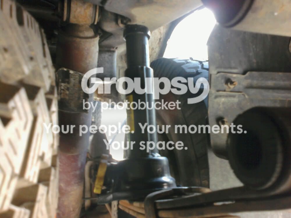

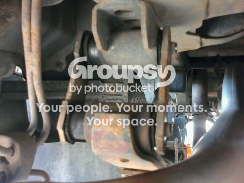

Never having done this before, I had to improvise some more by using a hand jack in between the leaf spring and frame to separate and get enough space for the new shackles to get in because the wheels remained on the truck the whole time I did this.

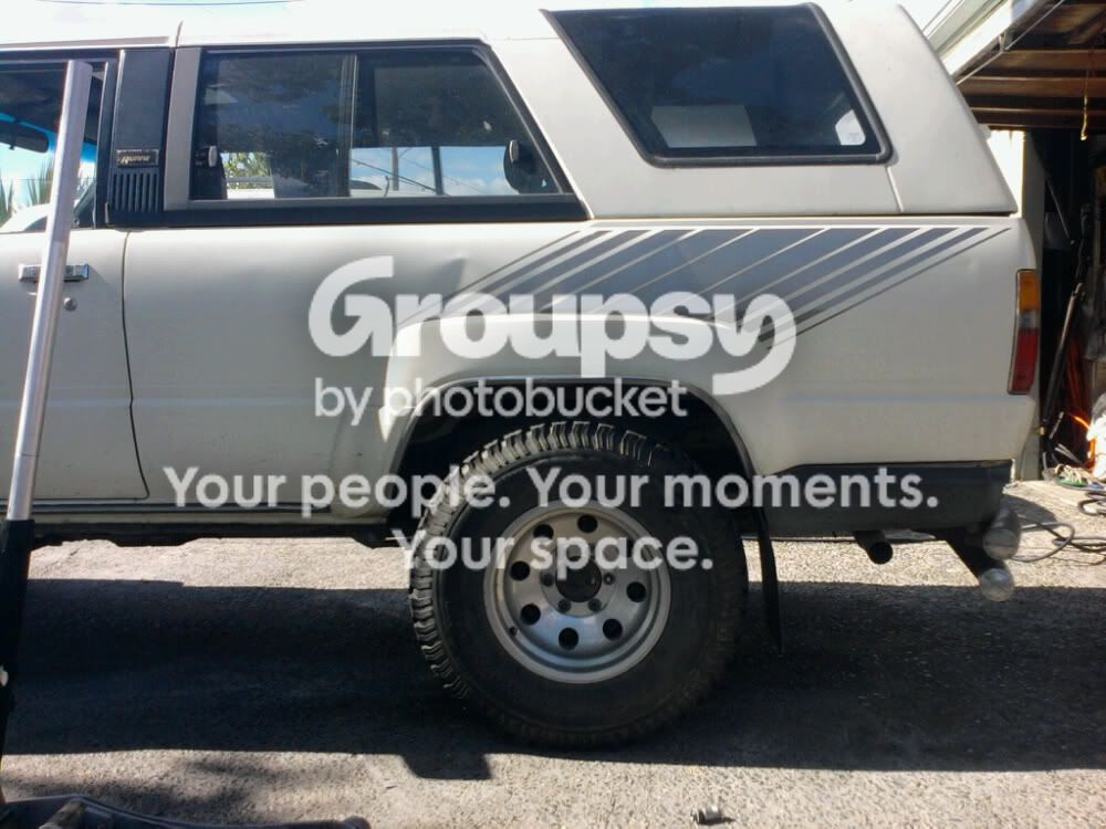

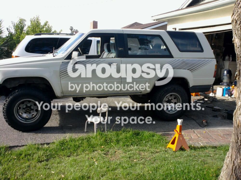

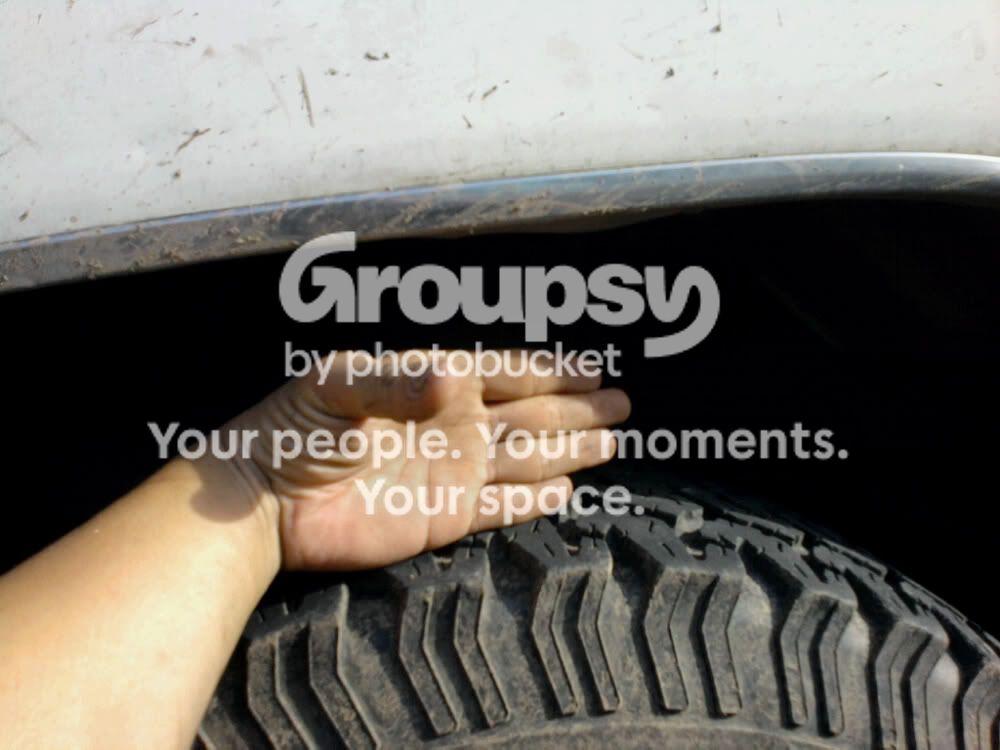

The whole thing was done rather quickly, I was expecting maybe a 2 hour job at least, but surprisingly it was done fairly quickly in about an hour or so. This was the end result, looks much better now and the shackles gave it about a 2 - 2 1/2 inch lift for the rear. I admit I was pleased, but I think I'm going to raise it more. I've been contemplating on 33's or 35's though so if I go with 35's I'd have to lift it and get it geared anyways.
