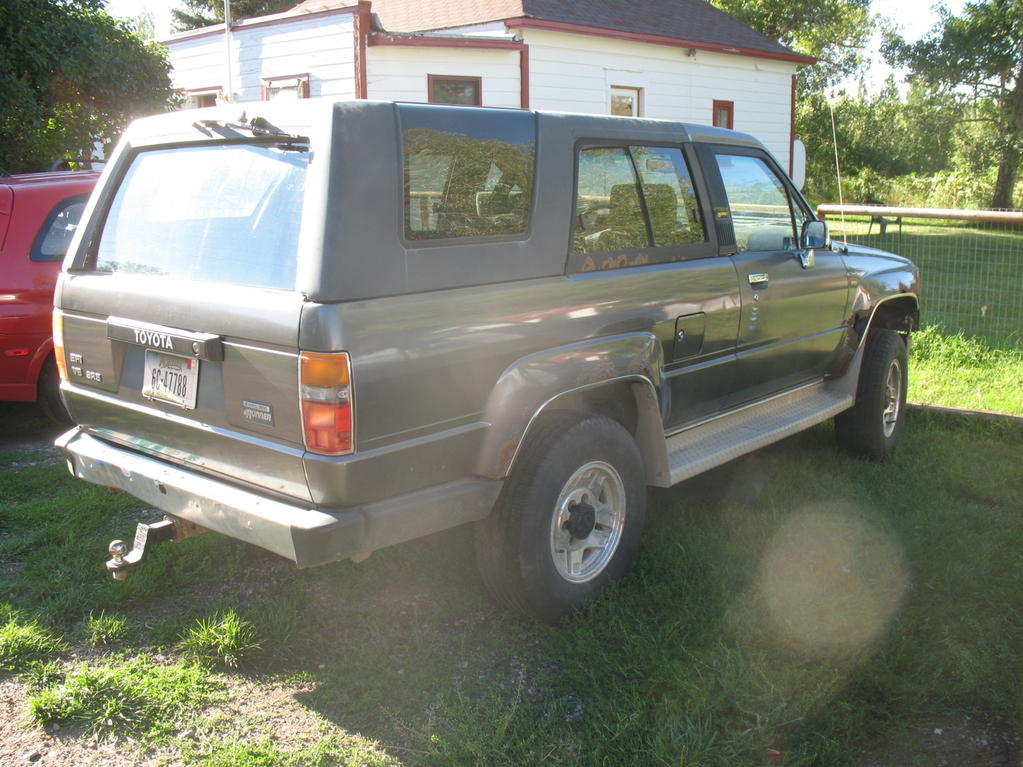

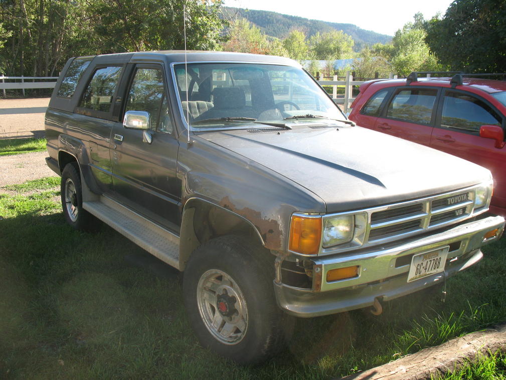

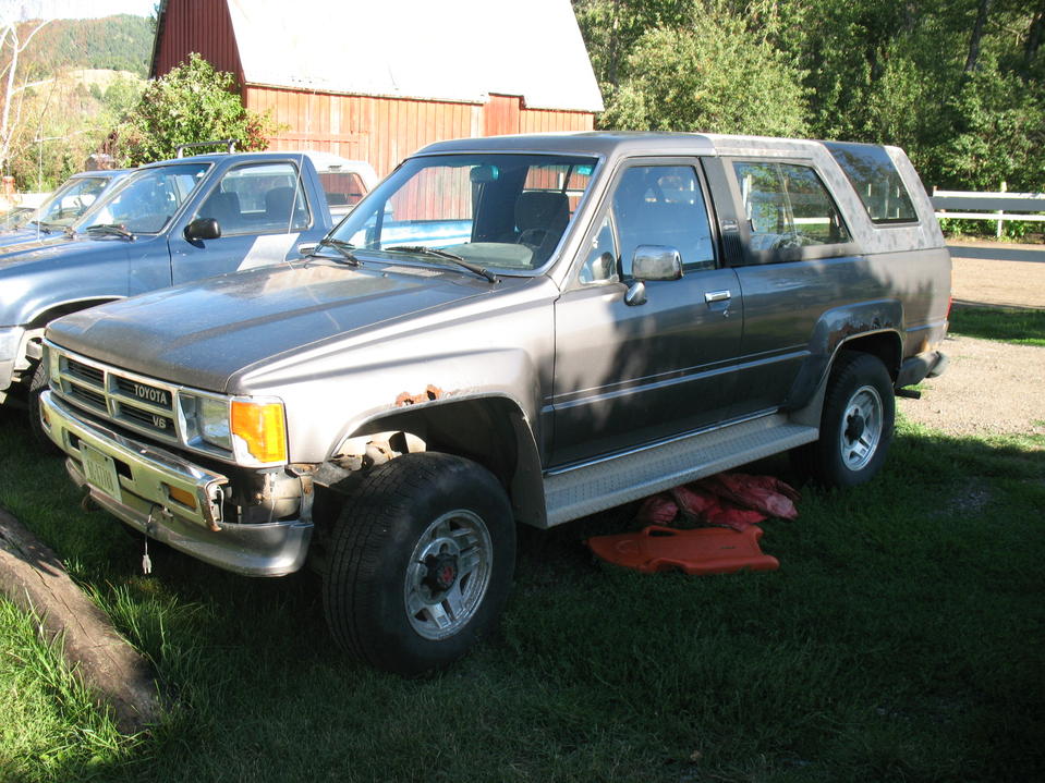

Hey there.
My 1989 pickup just died and i picked up this old baby....
I'm new to this site but wanted to get some help with questions before i take it in to a mechanic.
This is a V-6 with 180,000 miles on what appears to be an original engine.
First question.....engine starts great and runs strong but there is evidence of oil leaks around the engine compartment and I can smell what i think to be burning oil. Today I also saw some smoke coming from underneath the truck. It has been siting for about 2 weeks. Any advice?
I'll be heading to the yard to find some replacement parts for the damaged bumpers and rust...the interior is in great shape but I need a new drivers seat.
Any other advice or opinions would be much appreciated....
cheers
