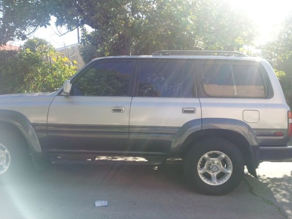

I found a 91 Cruiser FJ80, 233000 miles, salvage title, all original no upgrades. I can probably get it for just under $2000. really, really clean interior and exterior, orignal SoCal vehicle.
Current owner has had it for 2 yrs and hasn't done any head gasket work or noticed any issues and doesn't know when TB and WP were replaced last. He says the title was salvaged when he bought it 2 yrs ago. Said the seller then told him it was hit in the back and the bumper was replaced but did minimal damage. CA cars of this age get salvage titles for any type of accident.

Pics are below

Here are a few pictures to help you say yes

Looks clean, you in SoCal? I bought mine for $5k . After I bought it I did a baseline on it and never looked back.
