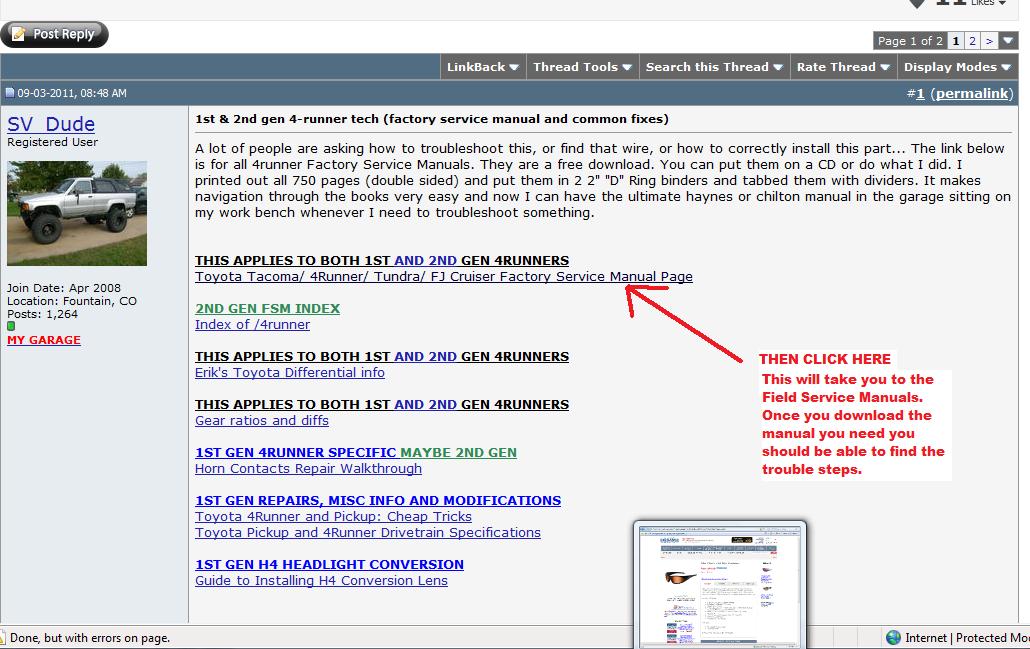

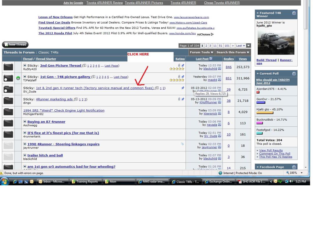

Hope this helps.

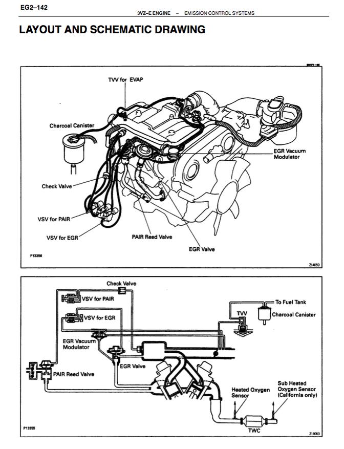

im trying to trace these vacuum hoses and i get incredibly lost... does anyone have a picture of where the egr valve and the egr vacuum modulator would be on a 94 3.0?
Thank you for the images. I have a 95' and after replacing the Valve Cover Gasket, I too got the 71 code. After doing a vacuum test on the EGR Valve and checking the filter on the modulator and checking all the hoses for cracks, I couldn't figure out the problem. This drawing helped me to figure out that the hose with the Check Valve was plugged in wrong. CEL is gone and I don't worry... I'm sitting on top of the word! :) Thanks guys
