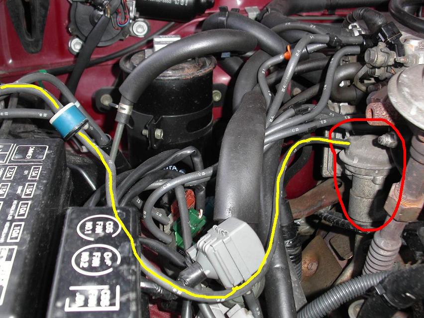

Yep. No vacuum at all, will do it. I realize there is an octopus of vacuum lines on that fender. Search down the ONE line that is supposed to be the source of the vacuum to the VSV and check it AT the intake. If the first section has vacuum, then work your way out toward the VSV.

Ive included a picture this time. The yellow vacuum hose is the one that leads through the "filter/valve" to the assembly mounted ontop of the wheel well inside the engine compartment. The part I have circled in red is where I assume the vacuum is supose to come from. I have removed the hose from the "valve/filter" and at the other end right from the part attached to the engine and no vacuum from the engine.
Is that even where the hose is suposed to connect? It seems to me that as long as the engine is running there should be vacuum at that point.

OK. I'm scratching this post. I need to look at it more closely in the daylight.
I'll post more when I have a better look at how mine is hooked up .
Mike in AR
Ive basically switched the hose i had in yellow with the position you said it should be in. I also had to change the hoses going to teh transfer case and Viola! it seems to work fine now. The 4wd light comes on and it definetly drives all 4 wheels in 4h and 4l. the only thing is that im not sure if the add is on when its in 2h. also im not sure what disconected from vacuum and plugged into the non vacuum.
