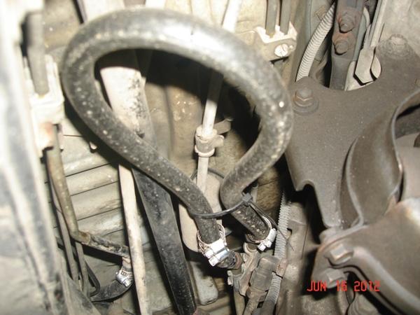

I by-passed my transfercase cooler by simply installing some transmission line hose and double clamps to both metal lines coming out of the case. So far so good... but I do plan to replace my cracked cooler when I can find one.

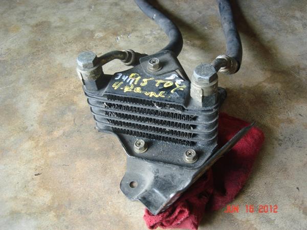

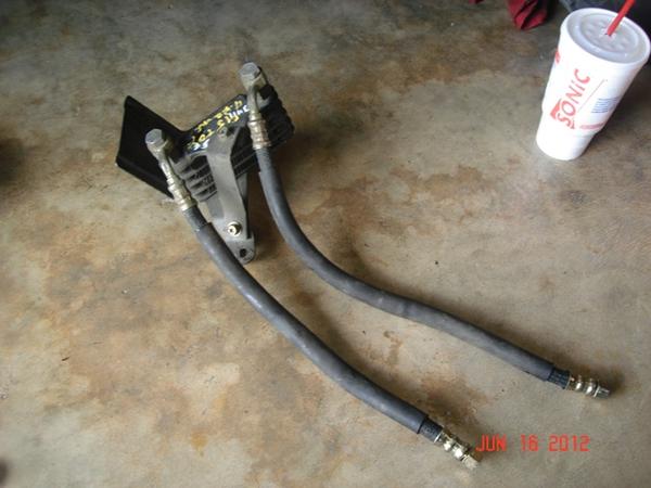

I finally replaced the by-pass hose with the proper factory cooler and lines. I replenished the t-case with fresh ATF and am now ready to hit the beach this summer! This is NOT a transmission cooler... it is an actual transfer case fluid cooler.
I've included a few pics...
The by-pass hose
Salvage yard T-case cooler
Installed
