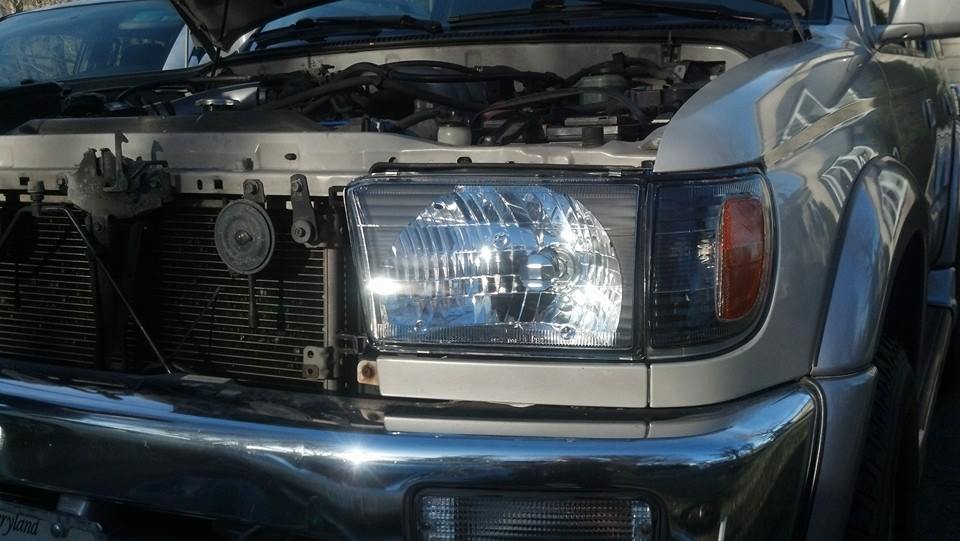

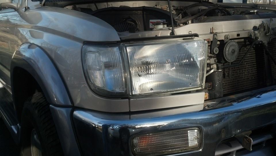

Just installed the ANZO Headlights paid about 200$ shipped for them on ebay.. They took off about 10 YEARS on the look of my truck..
What do you think?
OLD First
NEW Anzo Second pic.

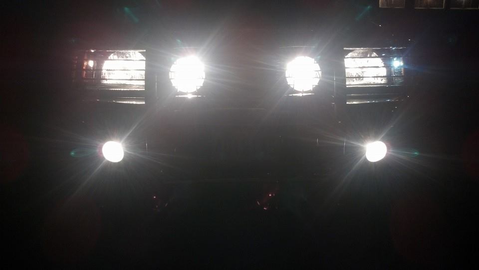

Bottom Night time. Definately alot clearer. I bought an OPT& H4 HID KIT But the water proof plug is in the wrong position of where it should be so i have not installed them yet.?? I have a SYLVANIA LED Driving light 194 bulb on the right and regular driving light bulb on the left. Testing out LED Bulbs.

I have PIAA Fogs on the Manik Stainless brushguard. and i have hellas on the lower bumper. i obviously dont run the PIAAS on the brush guard while driving lol. The headlights are on LOW Beam with stock OSRAM bulbs in this pic

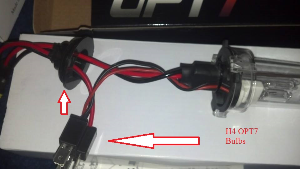

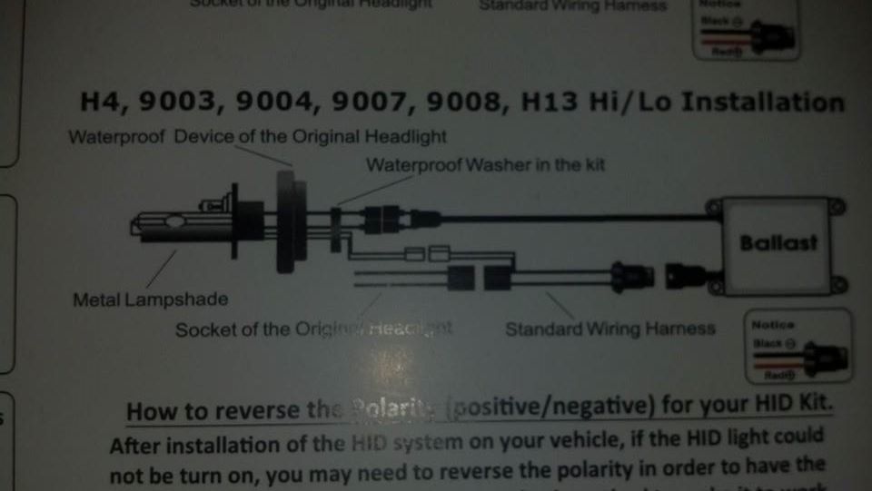

i got h4 hids. look at where the water proofing rings is.. im not sure how this is going to properly work on a 97 4runner? Any ideas??
The bulbs they sent have the water proofing ring before the connectors and also the connector looks different from what is in the picture instructions they sent me?
You can use a pin or small screwdriver to remove the blades from the headlamp connector, pass them through the grommet, and reinsert them back into the connector - similar procedure you'd use to reverse polarity as they mention.
Also be sure to reuse the factory headlamp boots to keep moisture out of the headlamps, as shown on their instructions. their waterproof washer goes behind the factory headlamp boot. You may need to modify the factory boot.
If the connector you received is wrong, send your kit back. Although if you are anxious to try it you can remove the pins from their connector and install directly into your factory headlamp socket one pin at a time; but I'd not drive that way, just test.

Those look like 99 headlamps/side markers with the faces painted black. Is the headlamp lens glass or plastic?
With the markers black, the bulbs basically become dots at night and defeat the purpose of side markers. I know because I painted mine.
The black "face" headlamp seems aesthetically pleasing but makes your car less reflective to other vehicles. I pained my entire reflective housing, face and bowl when I did my retrofit projectors and almost wish I hadn't - but that's water under the bridge.
I'm interested to see the mounting brackets/adjustments of that kit to compare to 99 factory, along with breather hoses, etc. $200 is a good price for both headlamps and markers if they are factory equivalent.
