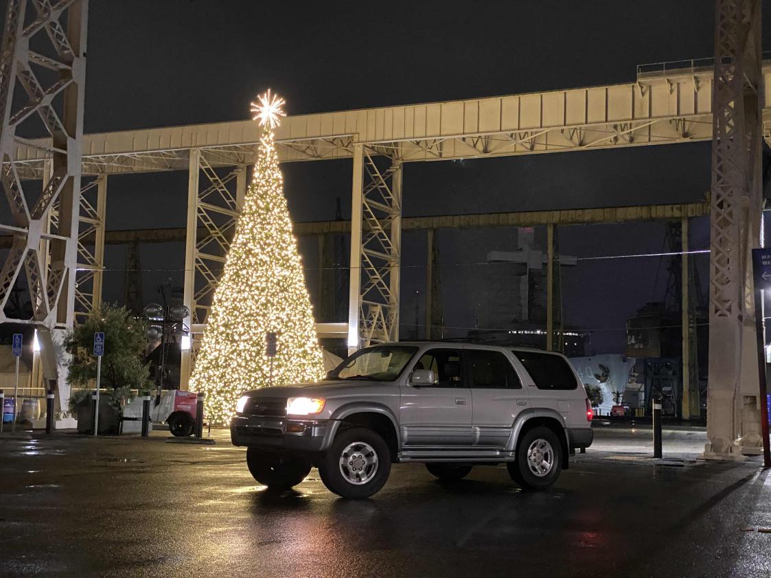

Hello all. I finally got my 1998 Limited on the road again, replacement engine completely resealed and it's running very well. First engine swap I ever did on my own, and surprisingly it just worked when I was done, nothing major to fix that I can see after a few days of driving. I also have a set of LBJ I am planning to install before doing any major trips or wheeling it.
Now that the hard work is done, I can focus on the fun stuff, modding. One thing I noticed right off the bat is that the rear suspension is tired and needs to be addressed. All four corners sit about 35" off the ground empty (measured at the center cap and from the floor to the edge of the wheelwell) but when loaded up the rear end squats very notably. The PO replaced the front end with some OEM spec Bilstein suspension so I'd prefer to keep that as is. I've heard good things about OME springs and Bilstein shock combo, what is the preferred spring if I want a good mix of capability and livability, leaning toward capability (I don't really care if it rides somewhat rough unloaded, it's a truck).
Another consideration, it currently has some street friendly 265/70 r16 tires and I am highly interested in upgrading to some A/T 265/75 r16 that can clear Tundra brakes down the line. Will there be any fitment issues with 32" wheels and stock ride height?

906 or 890 springs for the rear. Some people find the 906 springs to be a little harsh when unloaded and they provide 1.5-2" of lift in the rear over factory. 890 springs will be softer but you will get 2-3" of lift in the rear over factory with stock weight.
Tire size does not affect brake caliper clearance, only wheel size/design does. The current wheels you have will clear the 199mm Tundra brakes but will not clear the 231mm Tundra brakes.
I have 265/70R17 tires which are the equivalent of 265/75R16 tires and will only rub if turned and flexing. You might not rub at all depending on your ride height which looks a little higher than factory. OEM hub to fender height is 20 inches. Hub to fender measurement is easier to compare because it takes the tire size out of the equation.
