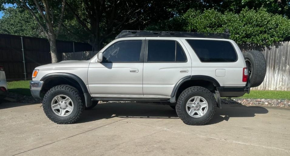

Hope everyone is doing well and enjoying your weekend. Looking for some answers on why my suspension is so unlevel on all corners after rehauling all my suspension parts. To start, here's some stats:
1998 4Runner SR5 V6 4WD. Refreshed with the following parts:

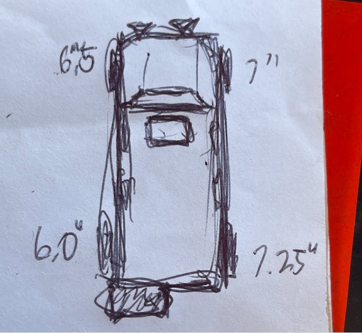

As you can see from the crude hand drawn pic, I've taken down some measurements. Unlike most of you, I measured from the top of the tire to the bottom part of the wheel arch. For those who can't see the pic:
Front drivers = 6.5". Front passenger = 7.0"
Rear drivers = 6.0". Rear passenger = 7.25"
Now of course I realize that the gas tank is on the driver's side and my rear tire is on the passenger side too, which should account for the droop on the rear driver's side. So, the tire + rim is about 75-80lbs. When I removed the tire and remeasured, the gap increased by only a quarter-inch (6.25"). The gas tank as of today probaby has close to 18 gallons, which I filled up 1-2 nights ago. So 18 gal x 6.06 (weight of a gallon of gas) = 109lbs + the weight of the gas tank (not sure of that). So roughly guesstimating, I would think the added weight should cause the rear driver's side to decrease no more than 0.75".
