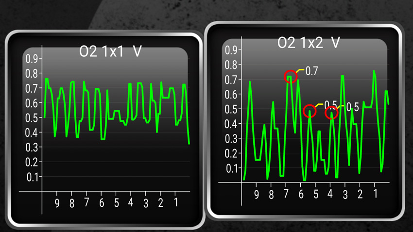

Below is a 10 second readout of the O2 sensors from Torque, by the way. The 4runner was at operating temp and RPMs were held at 2,500.

Torque readings and O2 sensor readings are hard to decifer. the FSM doesn't state specific voltages for checks, rather how many rises in a 10 second period and Torque doesn't read them well enough. If you cat is indeed broken, the only things that will clue you in is a P0420 code or a failed emissions test (which I don't think your state has). You could try and see if it's just the heat shield that is loose, perhaps that's all it is.
You'll notice a misfire most at idle, so that's not surprising. My guess is that the shop some how messed up the valves so it's losing compression. I know the shop kind of messed you up time wise but if they didn't do it right and damaged the engine, they need to fix it. An engine swap by a shop is $2500+
