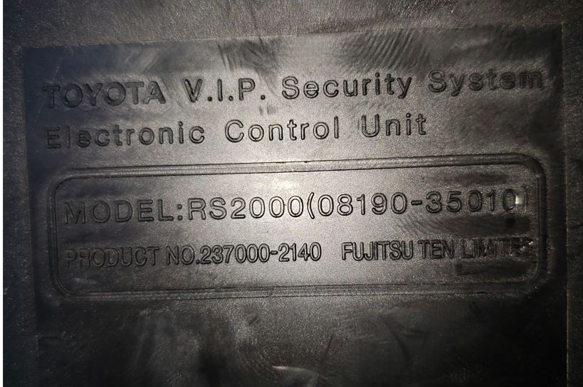

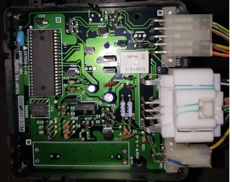

So I just bought a 1999 T4R with no key fobs last week. I was told by dealership it had the RS3000. So i ordered the gray key fob and went to program it to find out it has an Vehicle Intrusion Protection RS2000. It doesn't have the green program button. I opened it up to see if there was something i could push inside the black housing and found nothing. I did see that on the green circuit board it does say RS3000...My questions are... is there a way to get fobs programmed to this board or can i buy an RS3000 ECU with the green program button and swap it out? Thanks

Despite the plastic saying RS2000, it's listed by Toyota themselves as an RS3000 unit:
0819035010 - Vip security system, rs3000 plus - Genuine toyota Accessory
Beyond that, it looks like Maybe the "RS3000 Plus" and RS3200 are often interchangeable (lots of search results), so try these program instructions:

Well I tried the sequence several times and got nothing. I went to local Pull-a-Part and ended up finding an RS3000 ECU out of a Rav4. Made sure it had the green program button and took it home and just plugged it in & replaced the RS2000. Pressed the button and was able to program 3 key fobs no issue. I appreciate the response. Thought I'd leave a follow-up in case someone else needs the info.
