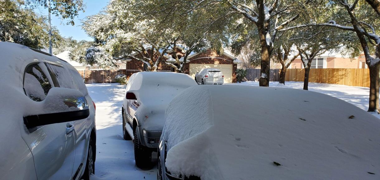

Here is it before our drive today. With 220,000 without power in austin, i had to drive across town, about 40 miles round trip, to pickup my son and bring him home (no power or water for 2 days makes mom want him home).
