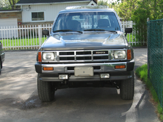

My dad has a grey 1986 Toyota 4Runner SR5 with the 22RE engine, with 100,000 km on it (about 65000 miles) -- all on the original motor with no rebuild, etc., pretty much all highway
There is no external rust on the truck (it's paint is still perfect, and is constantly waxed, and has original clearcoat), whatsoever, and barely any rust underneath the vehicle either.
The truck runs perfectly, however, after all these years, the rear leaf springs seem to be sagging and not providing as smooth a ride as they used to.
When I drive the truck, I find I can easily bottom out the suspension if I'm not careful going over speedbumps, etc.
The truck is not modified, therefore, getting a lift kit, or other attempted modifications would not work well (the vehicle had never seen snow until 2 years ago, and now is a winter daily driver, and is constantly cared for by myself and my father), and the truck never goes offroad.
We've called around to local shops, and the dealership, and they all want about $400-500 (CAD) to change the rear leaf springs on each side (so about $800 CAD total), then add labour, total coming out to about $1600 (CAD).
We all know the truck's market value is essentially nothing, and, given it's nearly new condition, with so few kilometers (miles) on the engine, it seems like a waste to sell the vehicle, however, we feel that $1600 for stock parts is absolutely rediculous.
What I was wondering was are there any aftermarket parts available for the 4Runner, which won't raise it up higher (or noticeably higher) than stock (it is still running the stock rims, and litterally stock tires (We're probably going to change them this year -- but my dad sees no point, since they're not worn out yet, but I reason that after 20-ish years, the rubber has hardened), so, it would look odd having too much lift at the rear.
Also, we live in Ottawa, Canada -- there's not much by means of offroading trails, etc. -- we're pretty far out of the way for all that kind of stuff I think -- so, to find reasonably priced parts, for this vintage of truck, I'm presuming would be very difficult, so, if anyone could offer tips or ideas where I could get these parts for the truck, it would be greatly appreciated.
Thanks for all your help,
Khany2002

Nice ride. I can assure you that the market value is far from nothing if it is that low miles and that kind of condition.
