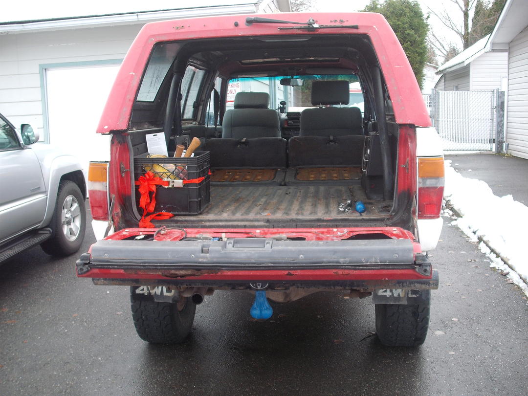

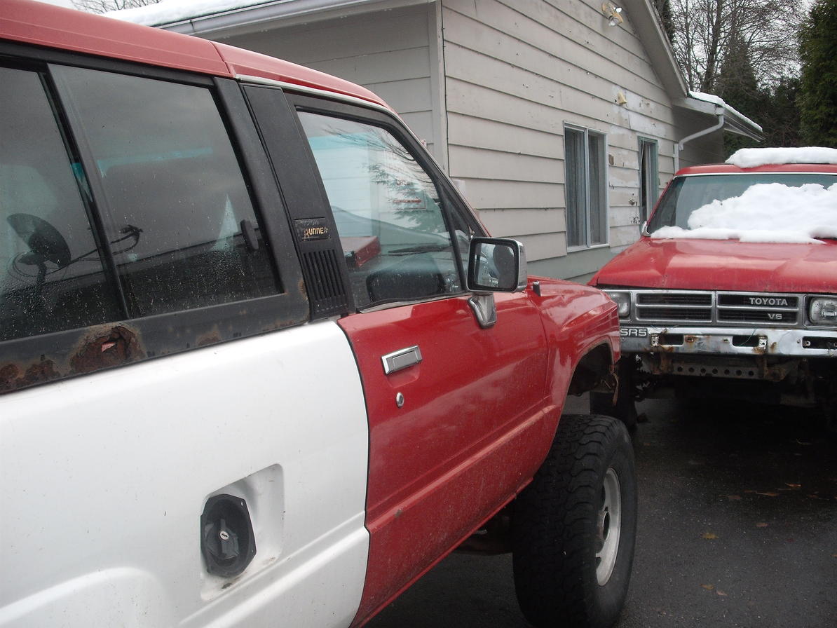

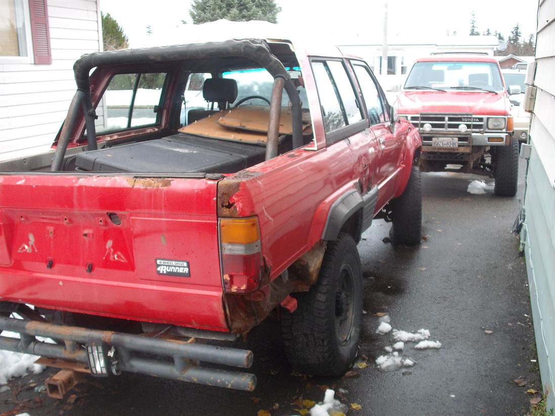

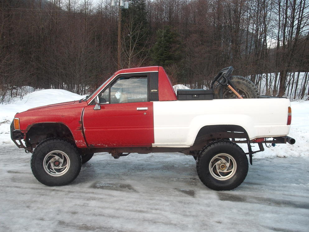

starting the "conversion"
just a few pics of the 4runner-truck conversion

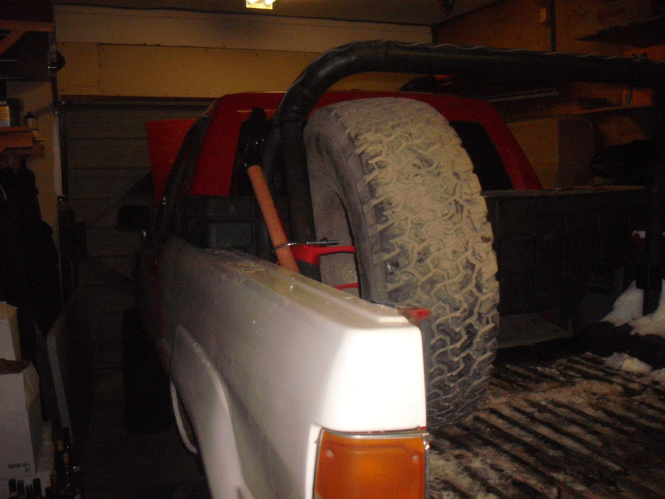

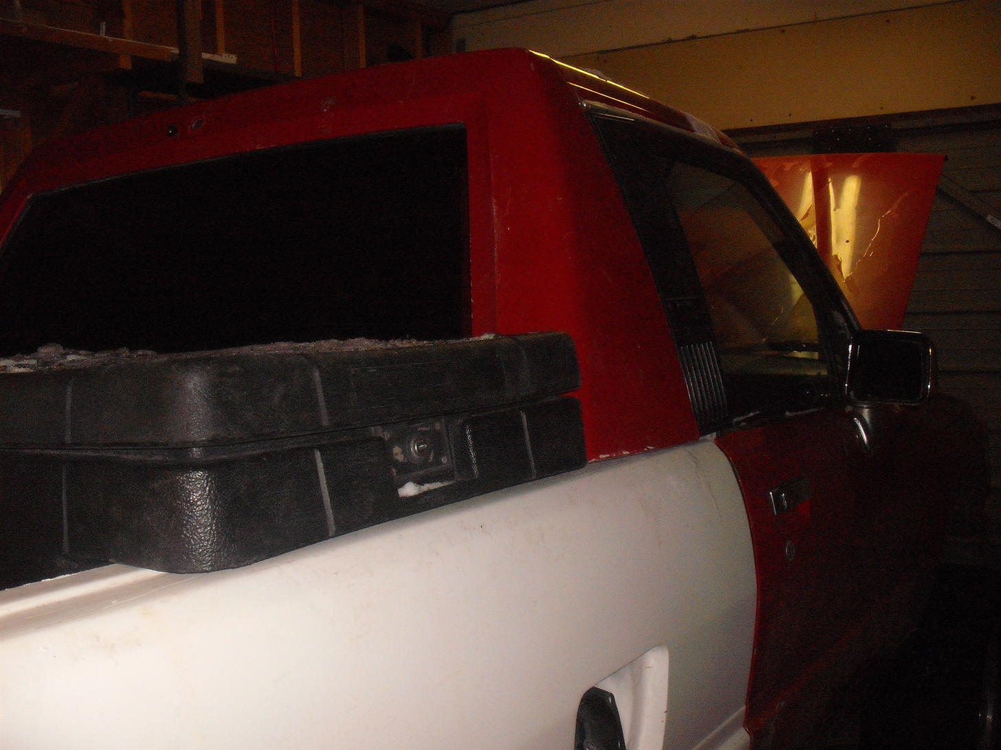

more pics
few more pics

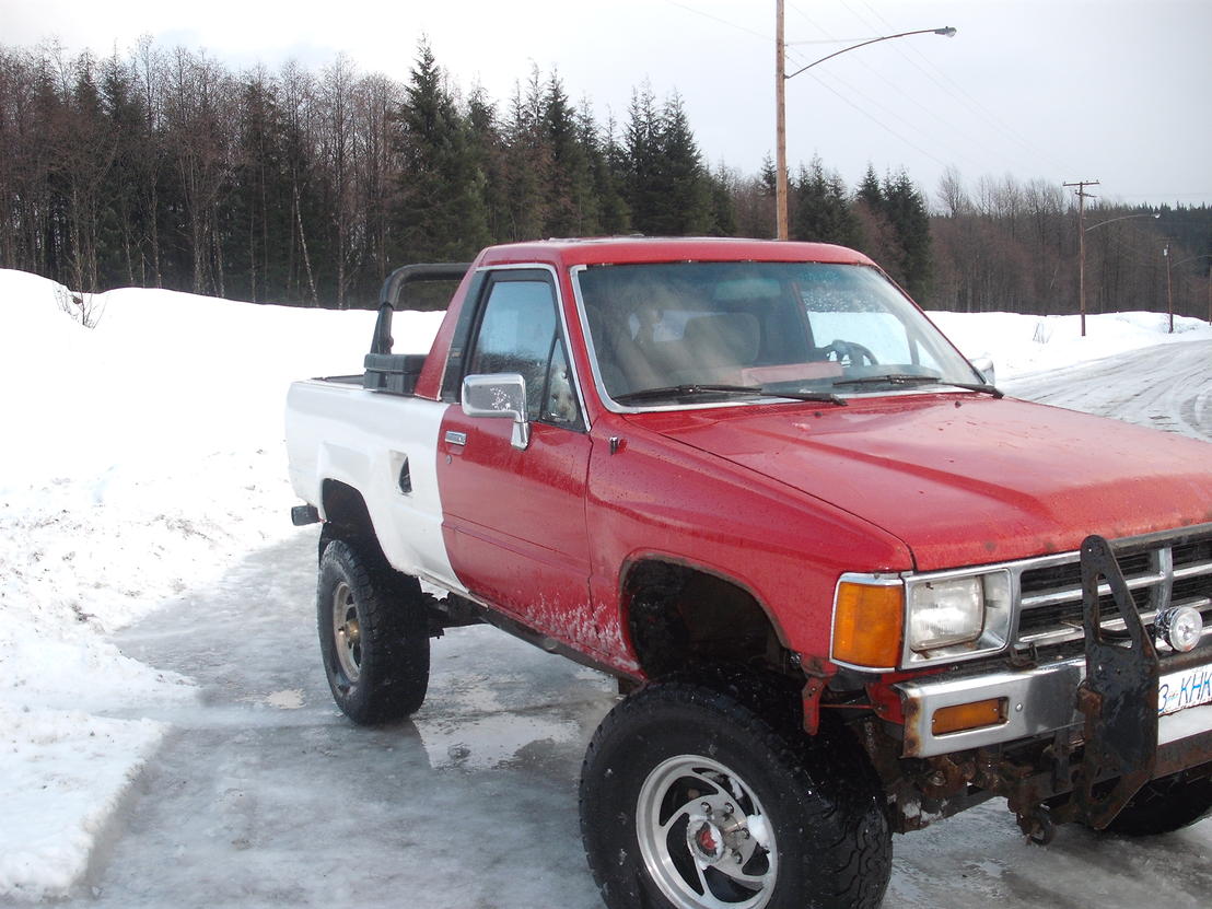

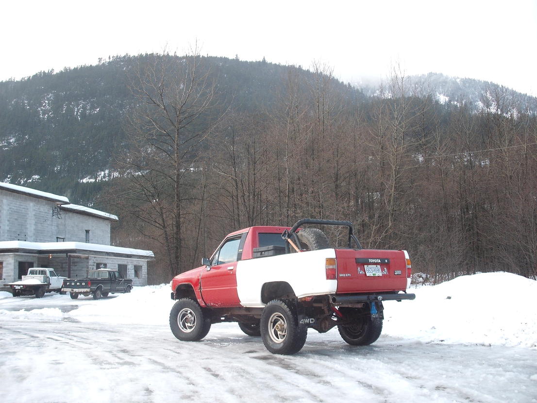

finished converting to pick-up
pretty much done with the "conversion", just need to drive for a few days and see if i notice any drafts coming in. the truck heats up way faster than when i had the full canopy on, and since i never really have any passengers, (that's why i've got the '05 T4R ltd.) i'm glad i did it!

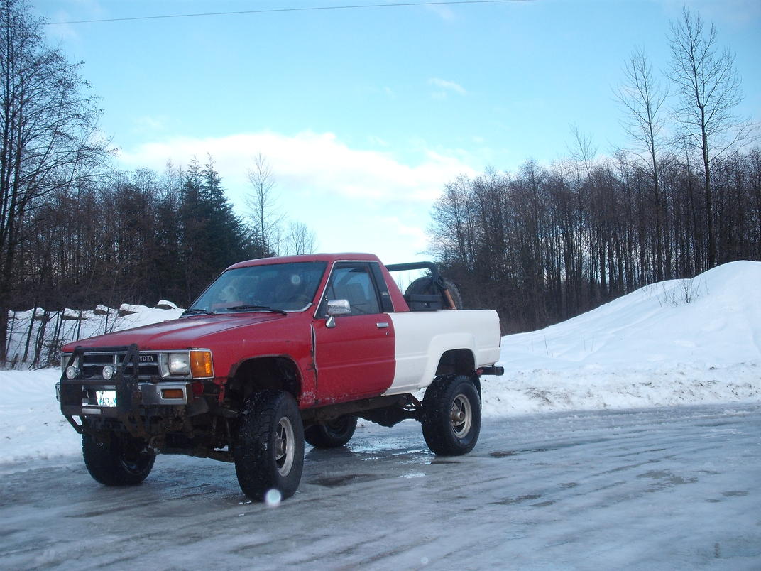

new pics
few pics of the the "conversion", anybody want to give me a paint job for xmas? haha

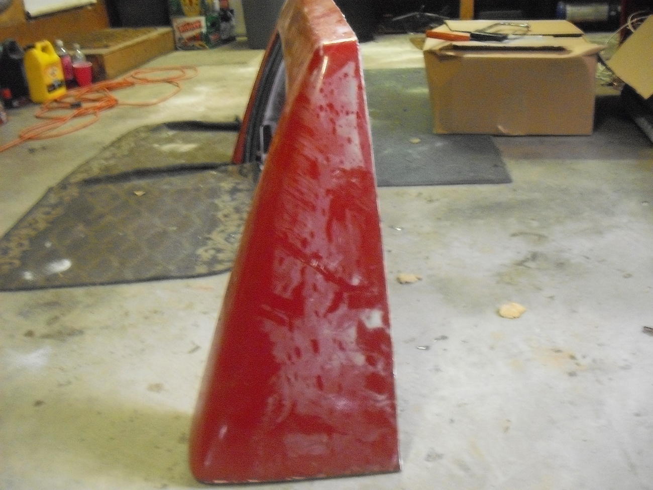

cool...nice job so is it easily reversible? you can just remove the back window piece? I have an extra canopy sitting here...hmmm are those fiberglass quarters? from penticton? thats an interesting conversion Ive never seen that before...:pimp:
Looks very cool! I would lend you the paint booth at my shop but we are pretty damn far away from each other.

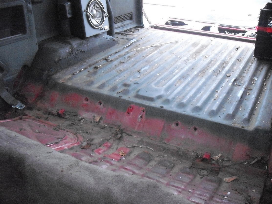

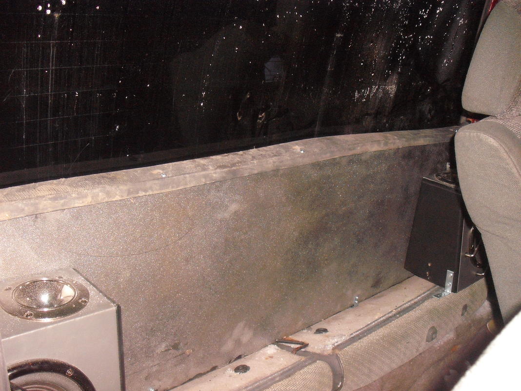

Do you have any pics of inside the back? I see you just folded the seats down and brought a panel from the window bottom to them. Just wondering why you didn't just remove them. Thought it would make some extra room behind the seats.
88T4RE>>> yup, fibreglass rear quarters from penticton, definetely worth the price you pay for em! and yes, it's easily reversible, i've got a "spare" T4R ('87 with 510,000kms) so i've got plenty of spare parts.
94Beast4Runner>>> appreciate the offer, but ya, a little too far away! i took the back of the rear seats from my spare T4R and folded them down, ideally i'd like to have the "rear seat delete pan", but kinda tough to track down. there's still plenty of room behind the front seats. what pics did you want to see, behind the seats, or in the bed of the truck?
