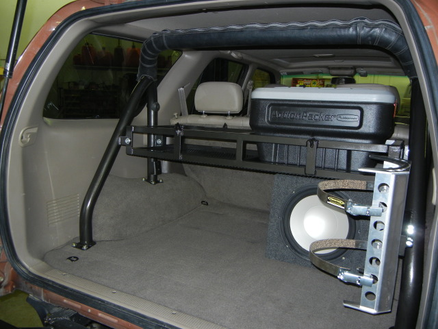

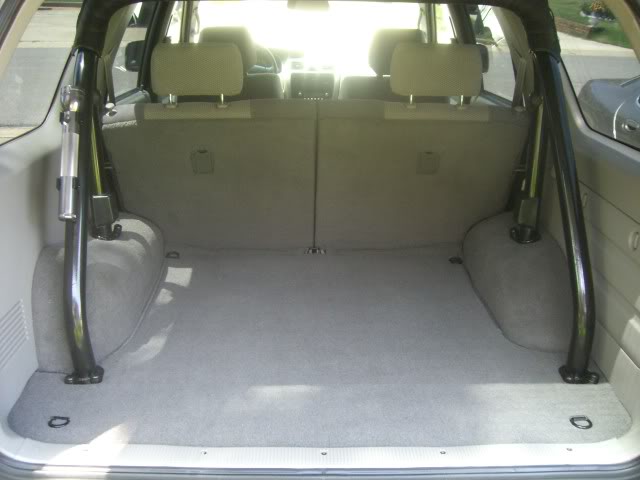

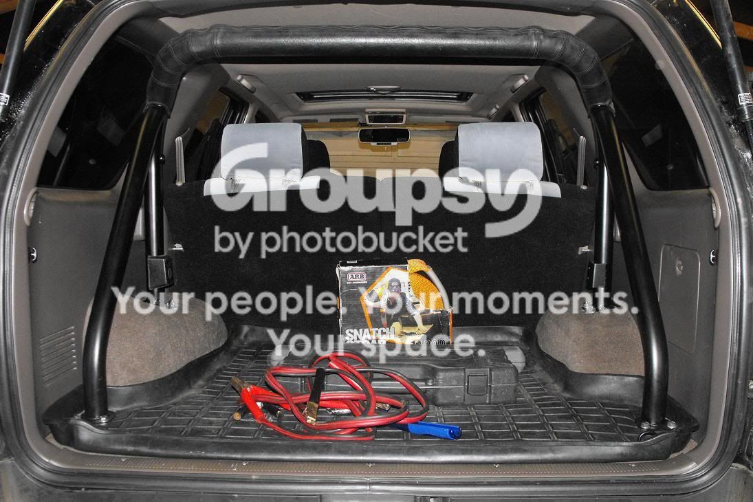

Installing the 1st Gen roll bar is pretty easy, but I’ll give you the quick run down.
Here is another short write up: http://www.toyota-4runner.org/3rd-gen-t4rs/91717-hulk-build-thread-6.html#post843883
First, I wouldn’t bother buying the roll bar from Sonoran Steel. You should be able to find one at a junk yard for cheap, or you could post a “Want to Buy” ad on the local 4x4 forums. There’s a couple guys selling them around here for $20 - $50.

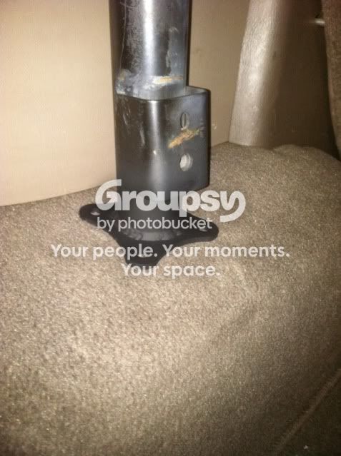

You have to cut down the front legs because the wheel wells are taller on the 3rd gen 4Runners. The measurements are in the above link. Most people reuse the stock plates but I used a couple larger and stronger base plates that have four mounting holes instead of two.

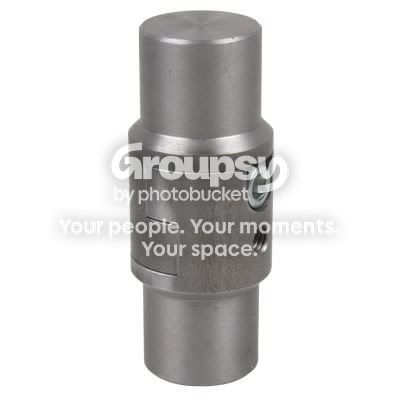

I also had a hard time getting it in and out of the 4Runner without scratching the crap out of the interior, so I installed an I.D. inner locking tube clamp. This let me install it in the back of the 4Runner in two sections and the roll bar padding hides the clamp.
Poly Performance JEEP/TRUCK & BUGGY*::*Brackets, Tabs, Trusses*::*Tube Clamps & Flanges*::*Synergy Suspension Interlocking Inner Diameter (ID) Tube Clamp - 4X4 Off-Road Parts, JK Synergy Suspension Systems, Fox Racing Shox, Beard, CNC Brakes, Johnny

Once you get it in the 4Runner center the roll bar and mark your holes. You will want to center punch them through the carpet, then pull the carpet back and drill your holes. If you drill through the carpet the drill bit will catch the padding and wrap it up on the drill bit, screwing up your carpet. Then you can bolt it in place using backing plates or large fender washers on the underside of the body. That brings up a very important subject: while the roll bar looks cool and makes for a good place to mount stuff, it’s not going to do much in an actual roll over. The roll bar itself is 2” .120 wall seamless tubing, which is good, but where it mounts on the floor is single wall thin sheet metal with no bracing around it. In a moderate to hard roll over the roll bar will punch through the floor.

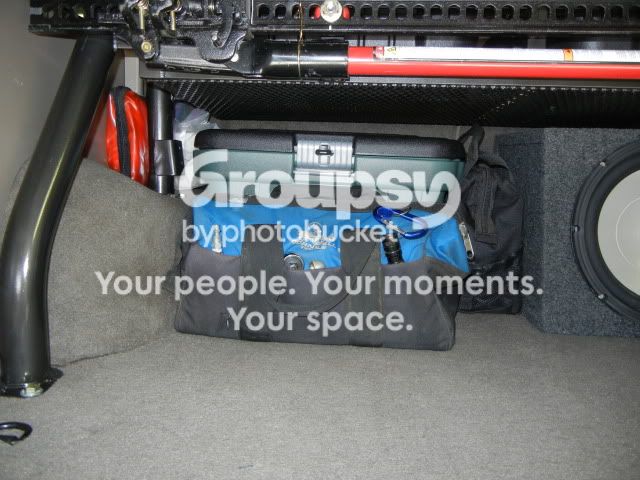

Thanks man! I really like how it turned out and how easy it is to get to all of my gear.

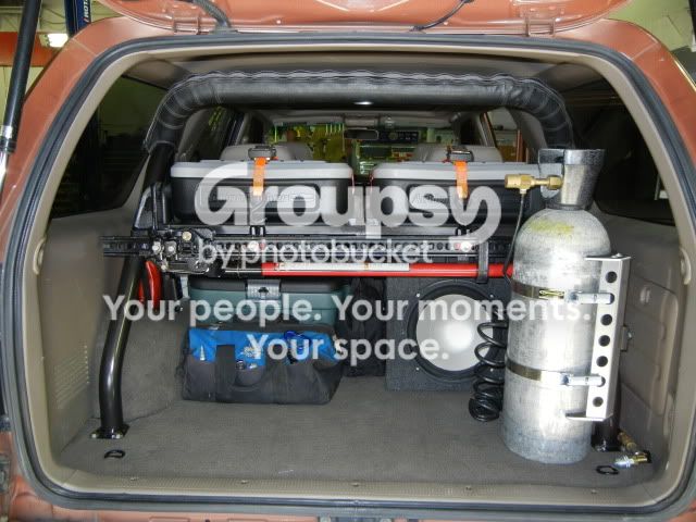

I got the roll bar from a buddy and it had the CO2 mount welded in place, I think that was causing most of the problems getting it inside the 4Runner. The bracket stuck out another 8"-10" past the edge of the roll bar.

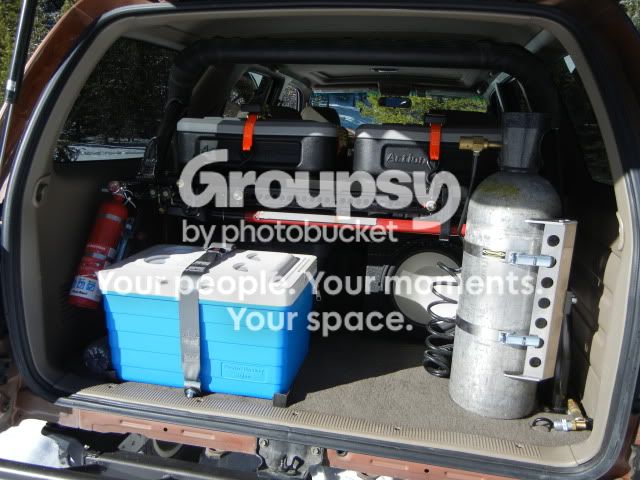

I love the nay sayers talking about how they need the cargo space, when dirtco's install clearly demonstrates how it can provide more storage with the use of a shelf. Also before I installed mine I hardly used the space on top of the wheel wells and the couple inches behind them that the rear legs occupy. It has provided me a space to mount my CO2 bottle more out of the way, my fire extinguishers and left the cargo area for anything I need.
