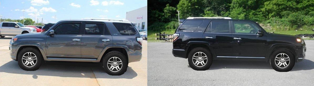

I cant use photoshop for shit, but I am thinking it would end up looking something like this:

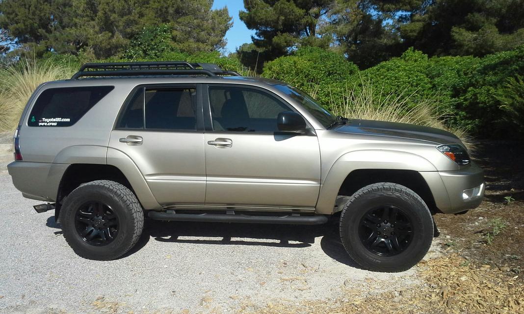

Son's 05
Not much help but ......pc-d black fit fine 275/70s :attention:
