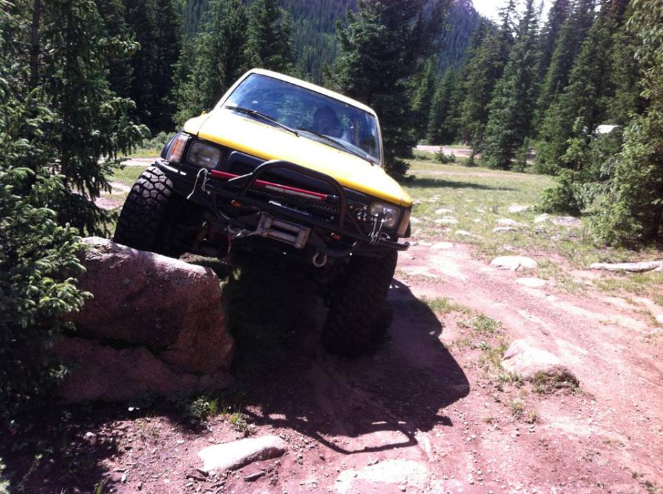

There ya go. IFS at full stuff with OME shocks and 2" ball joint spacers. With 33x12.5" tires they never rubbed, but they do with 35" on occasion.
