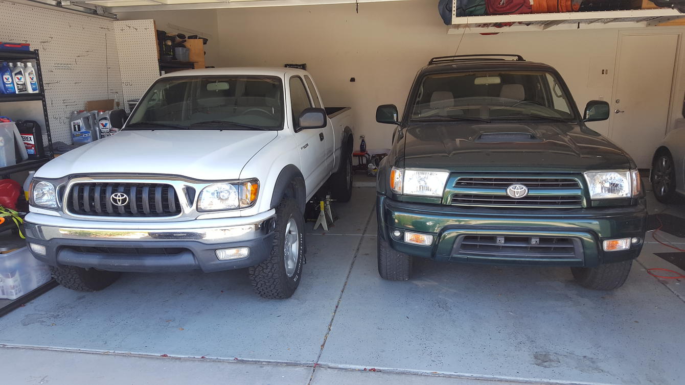

I waited a long time to get my 3rd gen companion for my 1st gen Tacoma.
Now we are a happy family.
