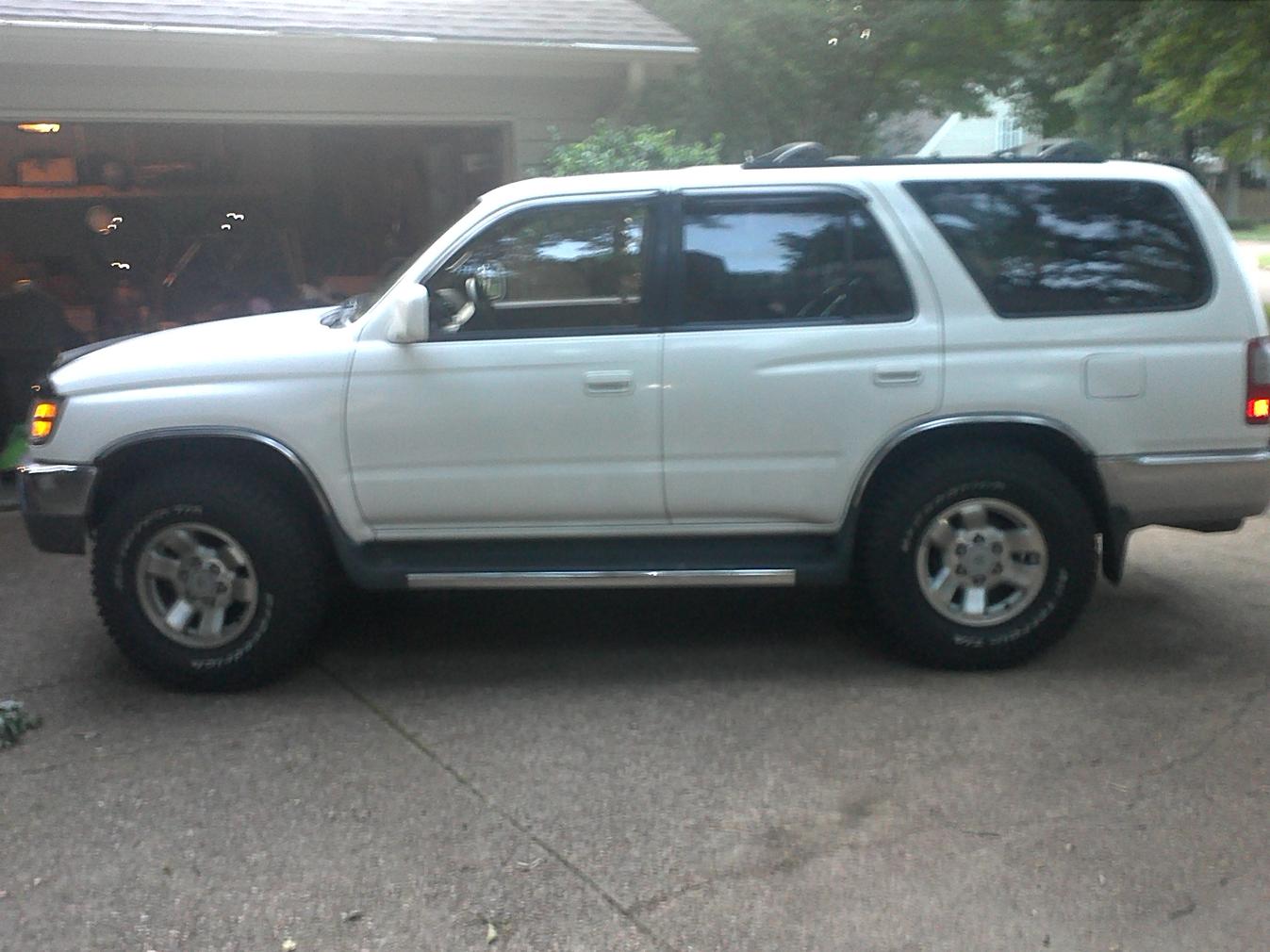

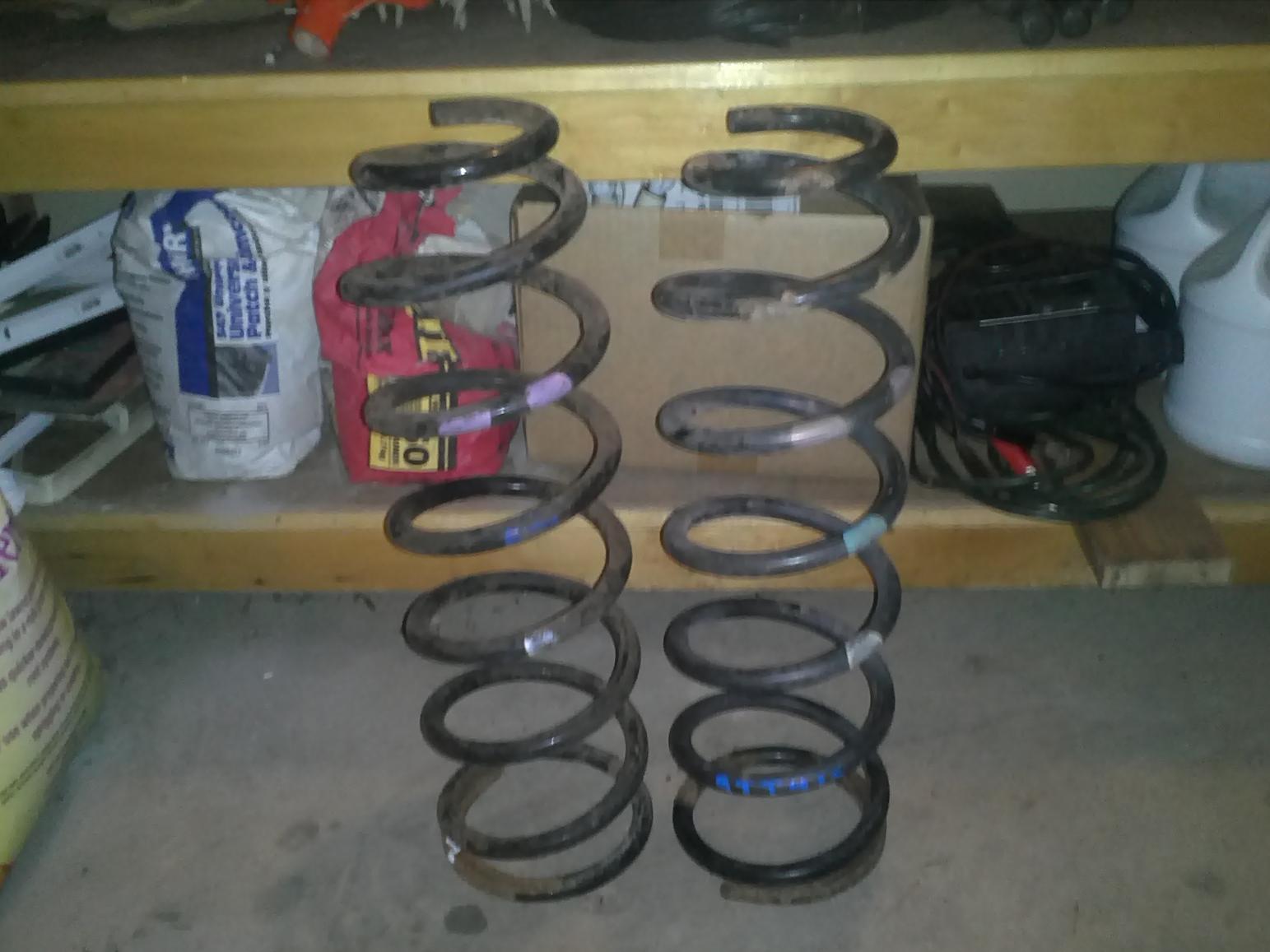

Got the LC coils today. Here are some pics. This my truck as is. It has 265 75 R16 Treadwright Guard Dogs on it. I haven't taken it out yet, but hasn't rubbed with regular street driving. The coils look like Purple Purple, Blue, white or yellow.

Got the back end lifted today. Got some mad rake since I haven't done the front. Had to get a spring compressor to get the LC coils in. Scary as hell using it.
