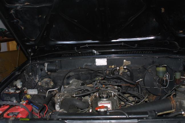

They moved it from the firewall to the drivers door jamb, it should be on there.
Lol. Can someone take a pic of theirs so I can tell exactly where it should be....I assume in the center of the fw, it not on the jam....that I verified. But the fw is quite dirty.....but 99% sure its not there.
decided to take one
here ya go
