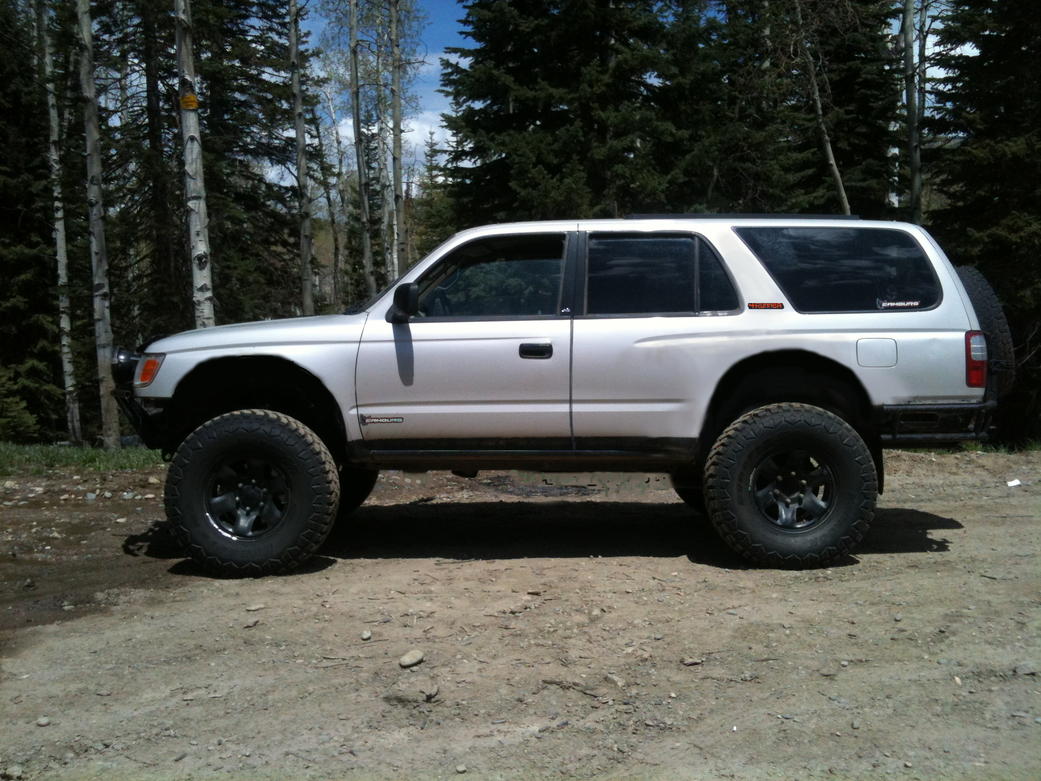

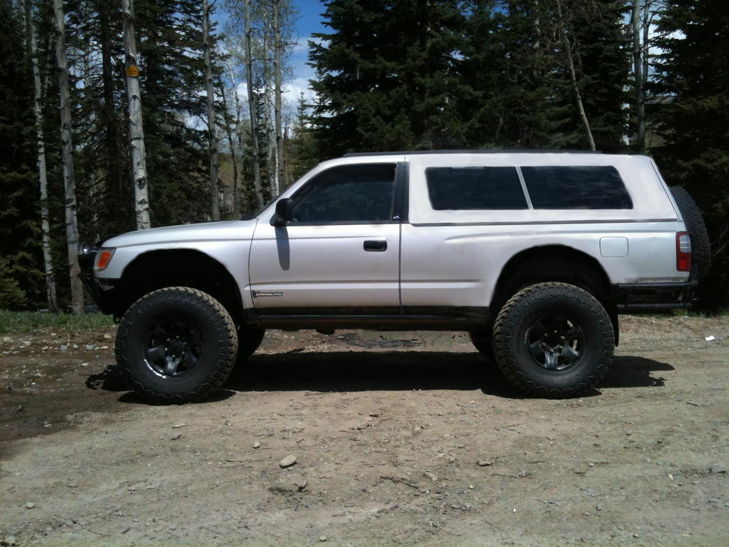

for a long time I've been wishing i had the 1st gen runner or even better a trekker with the removable top but then i went and got a camburg L/T kit and made a 3 link wishbone L/T rear so no i can get rid of this thing. so i am going to chop the rear roof off after the front of the cab ( like the 1st gen runners ) and mod a tacoma topper to fit and a tacoma tailgate instead of a hatch . roll cage will also be done during this process.
i need ideas or similar builds people have done (if they exist)
here are a few pics of what it should look like (photo shop).
1st pic is with a removable topper. 2nd is just 2door.
and yes that is my runner that will be made 2 door
thanks you all
matt

Very cool idea. I haven't seen it done by any one on the forums yet. Closest I've seen is a friend who made a 3rd gen pickup into a 4 door when he had a kid because he didn't want to get rid of his crawler. Looks exactly like a 2nd gen runner with the rear chopped.
Looks really cool and IMO way better looking than chopping off the cargo area. I'm really interested to see where this goes.
couple questions:
Are you going to put in a seat that slides forward to allow people to get in the back?
And, is a tacoma topper really the same size? (no criticism, generously curious.)
What about cutting the entire back off and mounting a Tacoma bed on the back end, chopping out the front of it, and building some rear seat brackets, throw some soundproofing/carpet in the bed, and get your topper on there, connect the 2 halves with Accordian boot seal and in theory it should be pretty watertight.
Pretty much making it a Walk-through cab 4Runner/Tacoma hybrid
It all works in theory, we all know execution is everything though.
thats a good idea it will all depend on if i could find a taco parting with its bed… i should be able to score a taco topper next pay check and il measure it up and see witch option is better.
