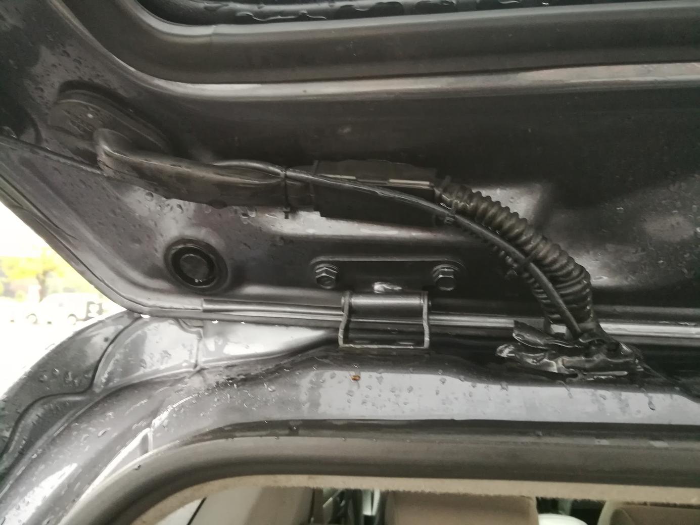

Ran mine through the rubber grommet and taped the crap out of it. I'll redo this when it gets warmer but for now it works. 3 Foot Firestik with spring mount on a K400.
