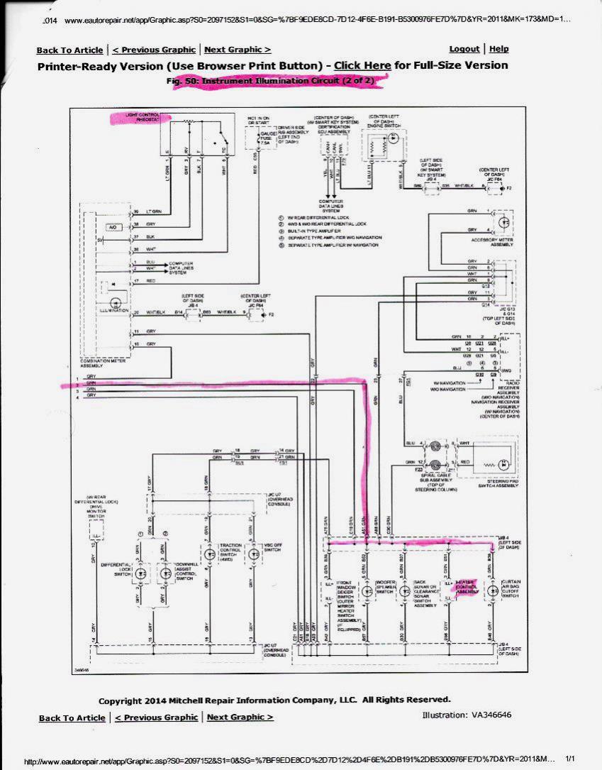

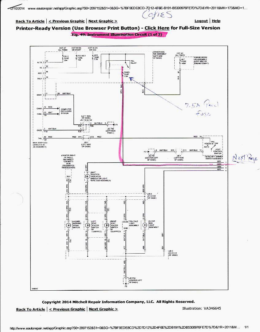

"...Does anyone have a panel light schematic? This is a great truck..."
Hi lj4r
I found the Instrument Illumination Wiring Diagram that you've requested; You'll need to study this 2 page wiring diagram to find what you're looking for, but I think it'll help! "Follow the pink trace to locate your components of interest!"
~rig~ ...pm or Mention me (@) if you need any help, BEST!

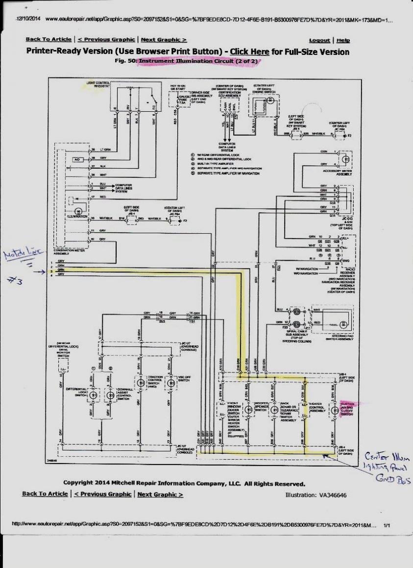

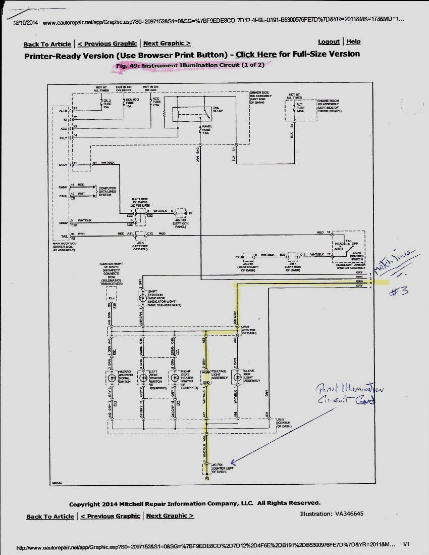

Hey Phil [ [MENTION=101358]lj4r[/MENTION] ]
I thought you could use these pages; same as the 1'st but these display the "GND BUSS" wiring path, a 'lil difficult to see... (Highlighted in Yellow trace)! Best, ~rig~
