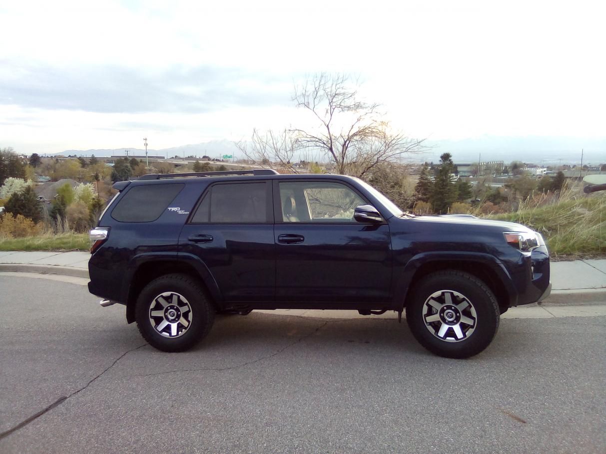

I'd say the standard exhaust on every 4Runner that is not a TRD Pro, is more at risk of being mangled. I know I keep it in mind when on a 4wd trail. I generally don't go on really difficult trails anymore, so it hasn't been smashed yet.
See my pic for an example of exhaust tip vulnerability.
376819d1613090509-nautical-blue-owners-post-your-pics-here-img_20200417_191426-jpg
Thanks for the pic. I don't have to go find one now on the road to see the rear type of pipe. LOL
Ya, that does stick out back some...they did on my Cruisers but we cut them back a few inches to shorten them.
I'm just going to have to take the thing out on a trail I know well and experiment.
I should add that what you see is the factory optional accessory chrome exhaust tip. I don't mind a little chrome, and it doesn't stick out much further than the unfinished pipe would. If I ever hit it, I'll be looking to modify it to a side exit like your TRD Pro.
