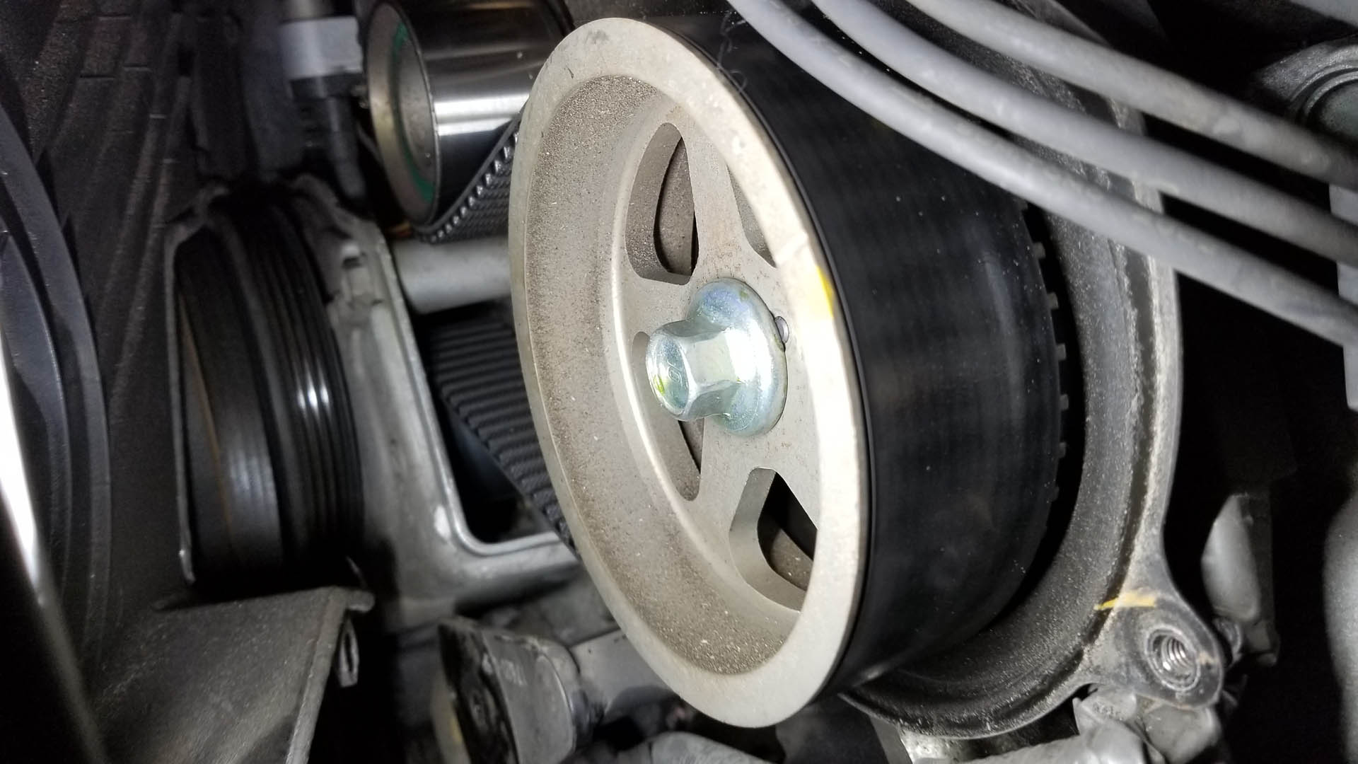

I inspected the ORIGINAL 20 year old timing belt with 150K miles on it. It looked surprisingly good. No cracks or signs of fluid contamination. I can tell it has stretched a hair as it had about 1/4 inch of play in it between the cam gear and first pulley, but still not as bad as I thought it'd be. I've got it on the list of maintenance items but I'm not in any hurry after seeing it.

I just pulled the top TB cover to inspect the belt. I don't think you can see the tensioner without pulling everything off to do the job? I'm sure if mine's not maxed out it's close, the belt had some flex for sure but not enough that it's gonna jump a tooth or anything yet.

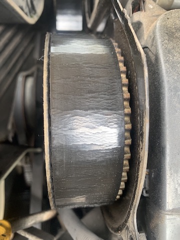

The TB job wasn't hard at all with the right tools. Toughest part was removing the back tensioner bolt w/o removing the A/C bracket. My belt was horrible at 220k and 20 years. Surprised yours has no cracks lol.
