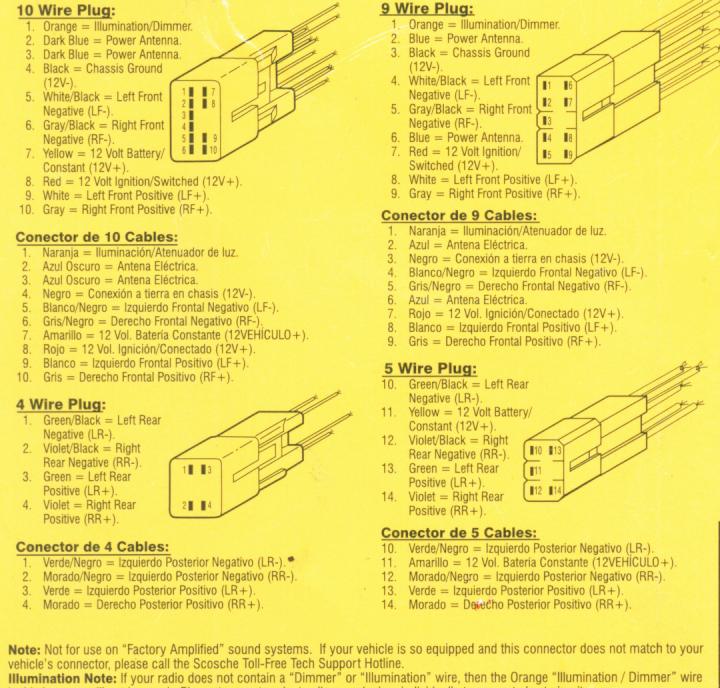

hey i have a 2000 4runner and i just bought 2 10" subs off ebay and i need the wiring digram for the stock 2000 4runner radio so i can wire in the amp for them

I bought this plug from Walmart when I did the install in my wife's '99 4R and it worked again for me in the '03 recently. It's easier to figure out when you have the plug in your hands, but it still should be a good reference.
Keep in mind that the pin-outs listed are for the plug in the kit, the ones in the harness will be the mirror image.
