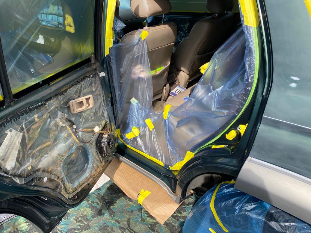

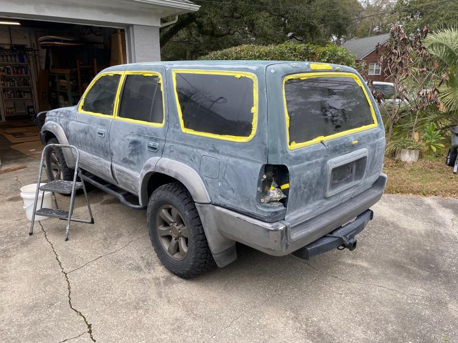

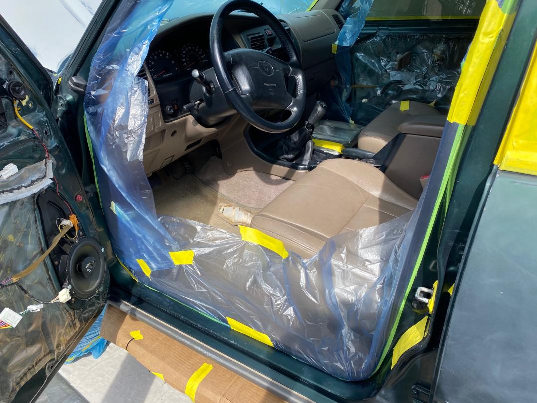

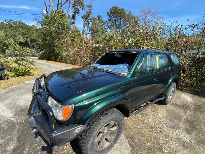

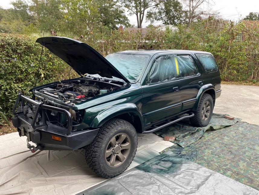

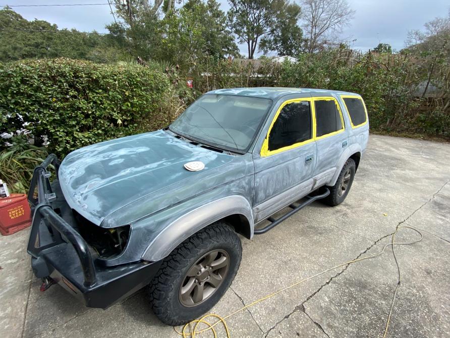

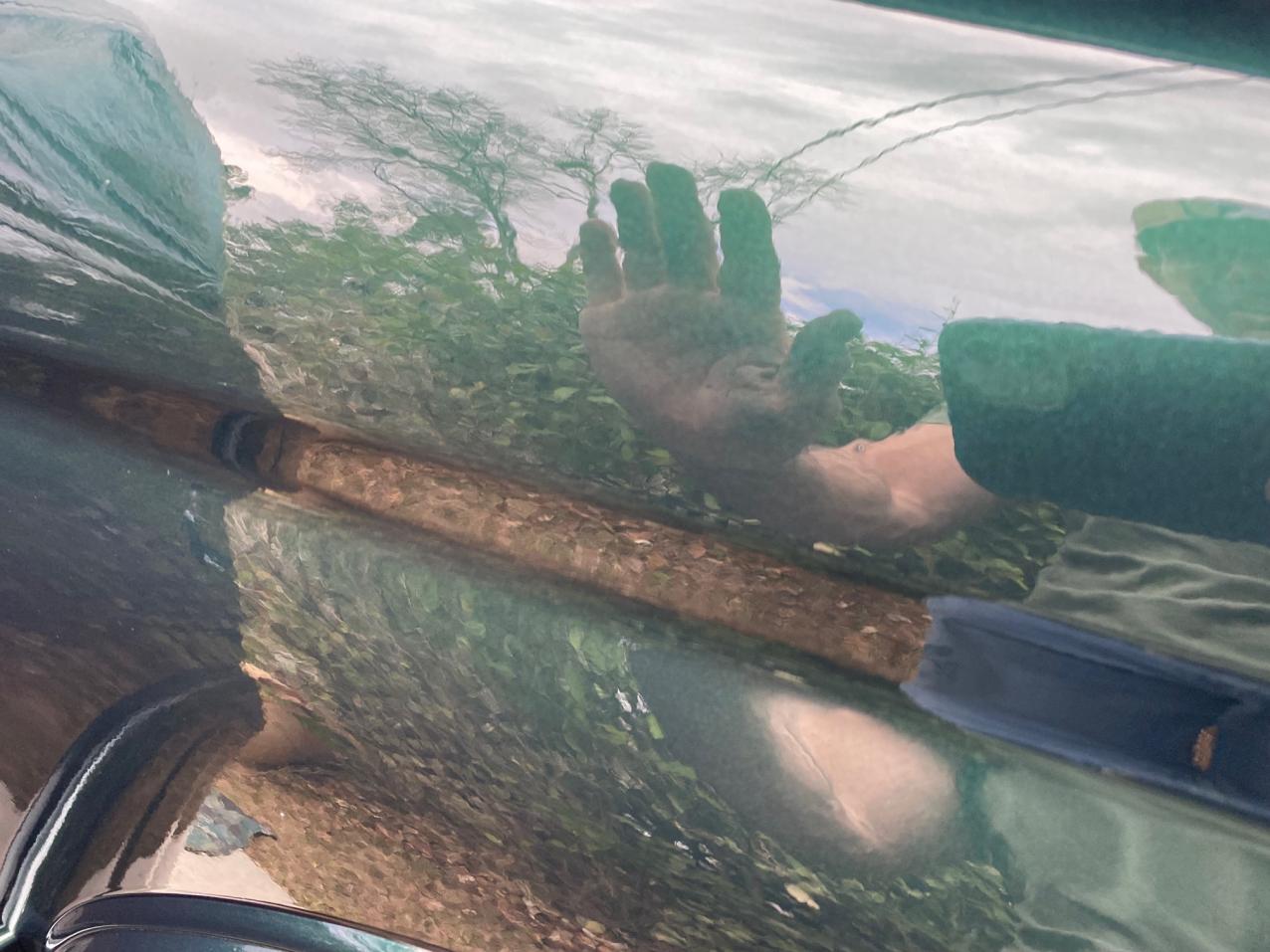

Big update! I painted the manual swapped 4Runner. Went with Tamco braind paint base/ clear . I chose the OEM color, Imperials Jade Mica (6Q7).
But what's gone now is the 2tone . I am loving the color again, and I am loving the solid color, I always felt the 2-tone was too 1990's. I showed how I masked to get the lower door jambs painted as well.

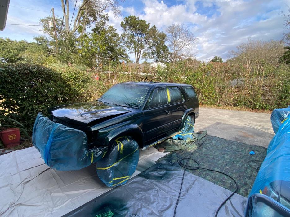

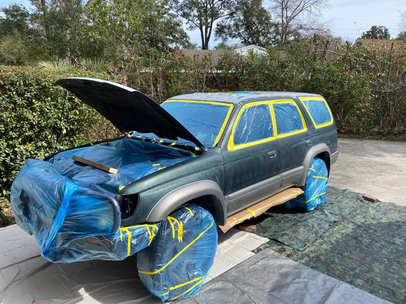

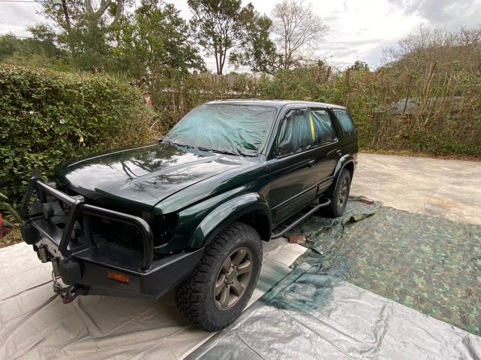

I really love this color, one of Toyota's best IMO. the truck looks so much more updated with the 2-tone gone.

Amazing build! Great looking results on the repaint, you did this yourself at home? Man I would love to get mine repainted.
yep, painted right in the driveway. came out 9/10. I strategically waited until February for a few reasons: #1 its not too hot out, air is cool & dry (no humidity) , no leaves or pollen flying around.
