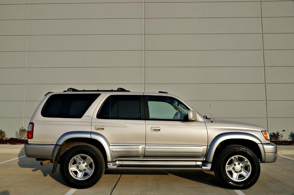

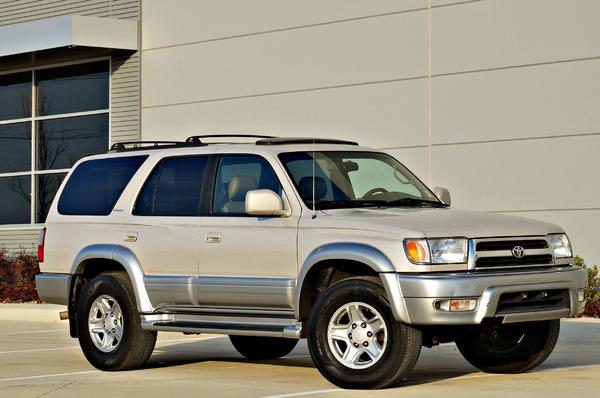

In the beginning
Update 4/2019
<a href="https://imgur.com/gEyPK5H"><img src="https://i.imgur.com/gEyPK5Hl.jpg" title="source: imgur.com" /></a>

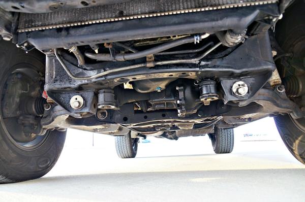

Suspension
Stage 1 Icon with target of 2.5" of lift and OME springs 906
<a href="https://imgur.com/r0Uj6zG">
<img src="https://i.imgur.com/r0Uj6zG.jpg" title="source: imgur.com" /></a><a href="https://imgur.com/yCHJ89b"><img src="https://i.imgur.com/yCHJ89bl.jpg" title="source: imgur.com" /></a>
I put a couple of thousand miles on this setup but after I put my bumpers on the backend compressed a ton. this show the original rear coils, the OME and the new Toytec 3" I finally ended up with, giving a bit of rake but I like me some rake.
<a href="https://imgur.com/QEyvoZo"><img src="https://i.imgur.com/QEyvoZol.jpg" title="source: imgur.com" /></a>

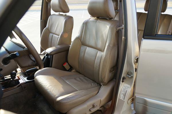

Front Seats refurb
I did a very long and detailed vid on this one.
and an extra truck wire part, a reddit user requested so... I do.
<a href="https://imgur.com/xD2YVoC"><img src="https://i.imgur.com/xD2YVoCl.jpg" title="source: imgur.com" /></a>
