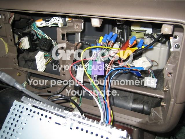

Blood curdling rage every single time I open up a dash on a car and see this:
IMG_3781.jpg~original

I agree. I hate seeing factory wiring all plumbed into and spliced up. It just screams hack job, even if it was done with careful consideration. It just looks bad and raises red flags to me. Soldering and heat shrinking together the wires to a factory replicated plugin adapter simply looks professional and gives peace of mind.
