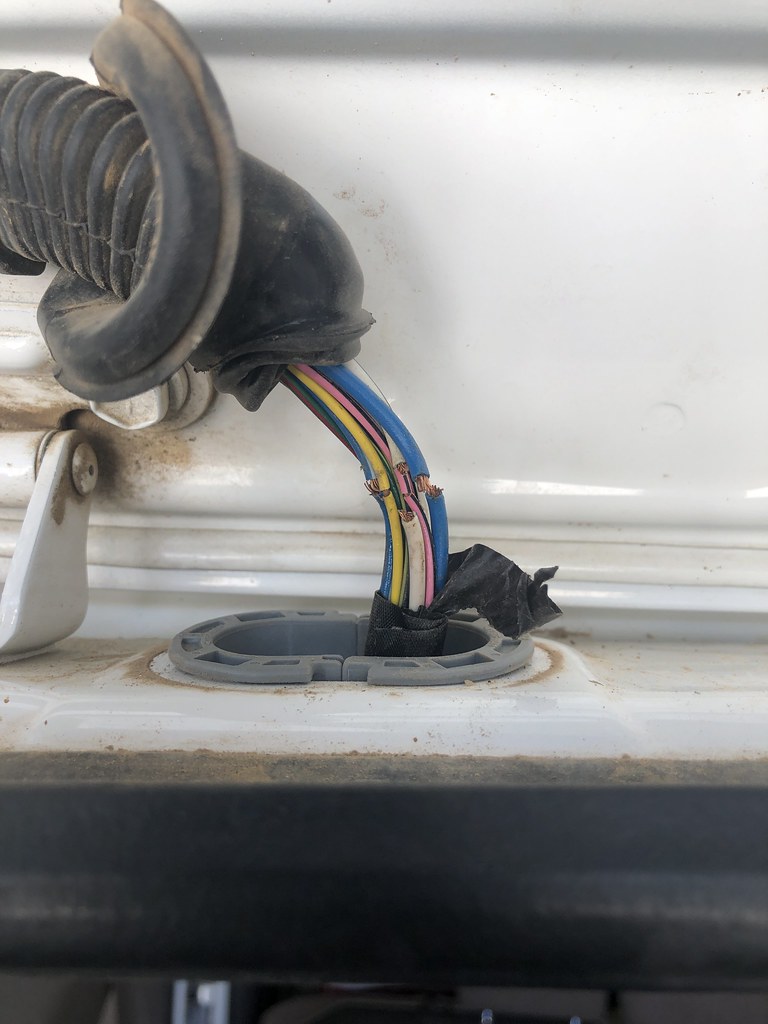

Bumping this back up, the problem has resurfaced.
The original issue was solved by replacing the ECU-IG fuse.
The current issue is that everytime I turn the key to "On", the ECU-IG fuse pops, so none of the systems that rely on that fuse work.
The issue appeared randomly, no deep water crossings or recent electrical work or things like that. But clearly there is a short somewhere.
I had a trailer wiring kit (Hopkins) installed that I had also tapped into for license plate lights on my swingout, but I removed all that wiring as it seemed like the most likely culprit for an electrical issue. Removing the wiring allowed the truck to operate correctly for about an hour, then the fuse blew while it was running and is back to blowing fuses every time the key is turned to "On".
Does anyone have a wiring diagram for all the circuits that run through the ECU-IG fuse? Troubleshooting help welcome as well.
Thanks.
Yeah, there is no such thing. The EWD goes circuit by circuit. PM me an e-mail address and I'll hook you up with the whole set.
This will not be fun. If you can't find the issue by physically looking at suspect areas, such as any modified wiring, then the first thing is to pull the 1G plug on the back of the inside fusebox. Basically, that fuse feeds a bunch of stuff on board the BODY ECU and then a bunch of other stuff elsewhere through that 1G plug. If it still blows with that plug pulled, issue is internal to the BOCY ECU and you know what that means.So I hope it doesn't blow and we can move on to other stuff.
I would also suggest you look for obvious signs of wear or chew marks from rodents. Good luck. Electrical issues are never fun.
