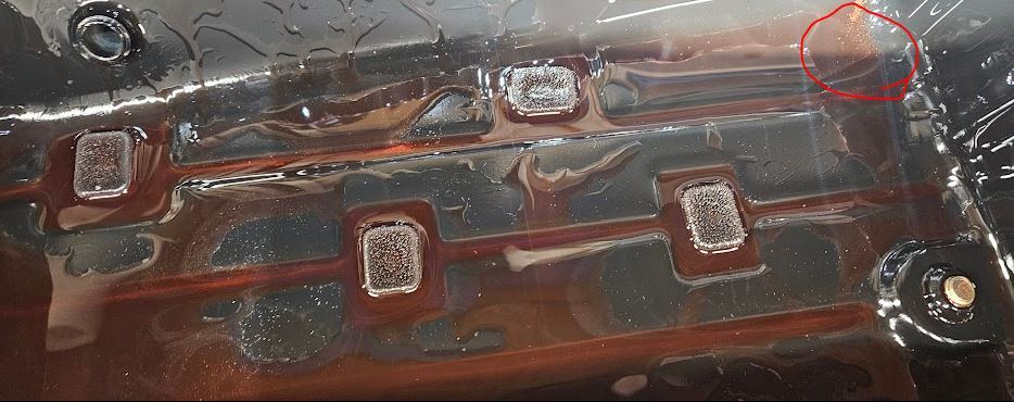

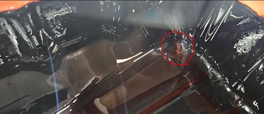

Here are the pan pics, with the only noticeable shavings to speak of. Magnets were barely coated with particles. The pan and filter were otherwise untouched since new. Trans fluid looked great and smelled normal.

The TC's bearings tend to wear first causing the whine as you described - may last another year or two - depending on pocketbook or skills you could replace just that or whole thing new or used - Luck deciding
