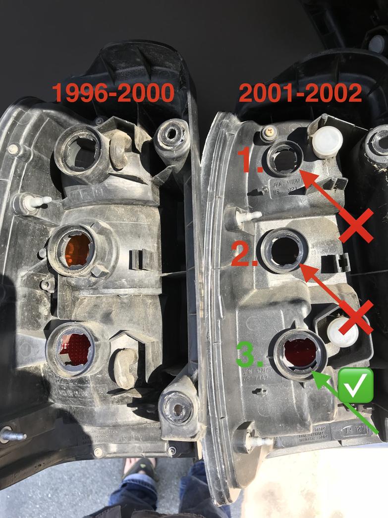

grab the wires from an 01-02 and splice the first 2 bulb wires and you're golden, I think. I will report back.
the 3rd bulb wires seems to fit fine btw.

Definitely no reason to splice wires! The '01/02 tails plug in right behind the tail light bucket- behind the interior quarter trim. Take the hatch threshold trim off, take one screw out, and you can pull the trim out enough to mess with the connector and ground bolt(10mm head).
Plug and play swap [emoji1360]
