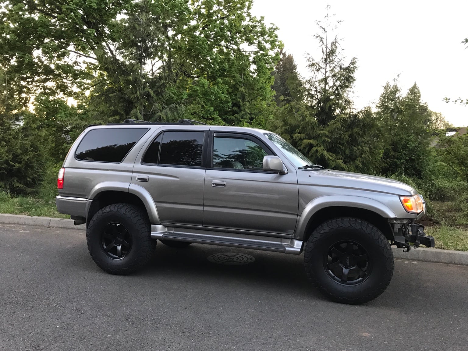

Are you building the ultimate 3rd gen??? 01-02 - Thunder Cloud Sport - Manual 5 Speed!? Dont forget the S/C & E-Locker & I will be totally jealous! :becky:
I guess I'm not the only one that thinks that's the ultimate 3rd gen! [emoji41]
It's not a sport. I actually didn't want a sport, as I don't like the gray interior. All the 01/02 sports I've seen have had gray cloth; I love my Black and Tan and leather! I do want a sport hood though- who doesn't?!

To each his own, but after 17 years of Oak I'd like the Grey with Silver Sport interior trim. It goes perfect with Thunder Cloud Metallic. Adding Black & Tan to the mix will not win any interior design awards. LOL
Also the Sport seats are the most comfortable 3rd gen seat, aggressive looking hood & great flares too.
What are you doing with your truck? Anthracite Metallic is a great color too as long as the clear coat isn't turning white.
Haha maybe not, but I definitely like that combo best!
The flares are the same as 00-02 SR5, right? They look the same.
Yeah, I do love my Anthracite. The clear was white, so the place I got it from had the hood and roof sprayed before I got to it. I'll be posting it for sale after I get the AC recharged and ignition replaced- I doubt anyone else could figure out the trick to turn the current ignition on [emoji23] "Just wiggle the tip around as you slide it in" might not be a strong selling point.
