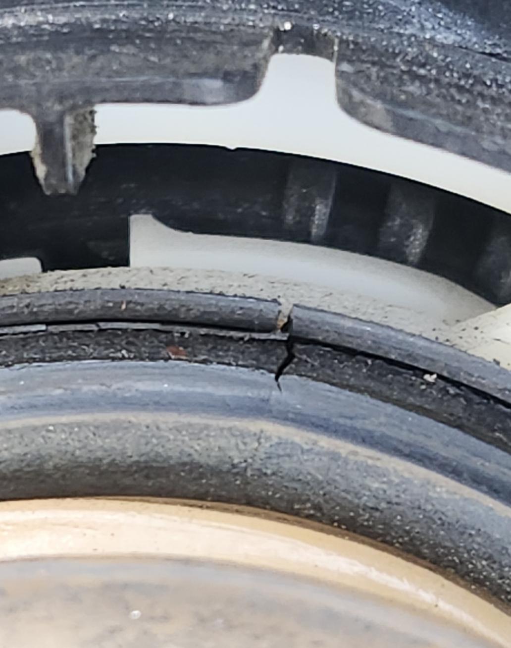

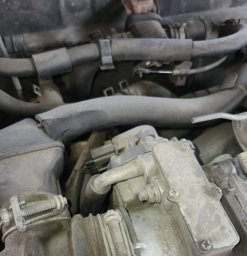

Both codes active. Any chance the small tear in the gas cap gasket could be the problem? Or does the hose play a role in the vacuum checks? I'm not familiar with which hoses but I did not see any others in the engine bay looking questionable.
Thanks,

The big hose in that picture that has a bit of oil staining is a valve cover vent hose. That should be replaced/fixed but isn't the cause of any evap codes.
The 01/02 trucks have the evap system mostly under the truck in the back. That gas cap could be your only issue (get a new OEM one), but more likely it is a seal on the gas tank, valve on the top of the tank or something with the hoses/pipes to/from the tank/canister to the engine.

Thanks Phattyduck. Ordered OEM cap. Trying to find part number for the hose. I think it is 12262-62060. Anyone else know for sure?
Looks like cheapest option is ordering from Amayama in Japan.
It looks like it just slips on at both ends? No clamps of any sort needed.
Yup, no clamps on that vent hose. You might also be able to use generic PCV hose in that location, it isn't too heavily molded.
